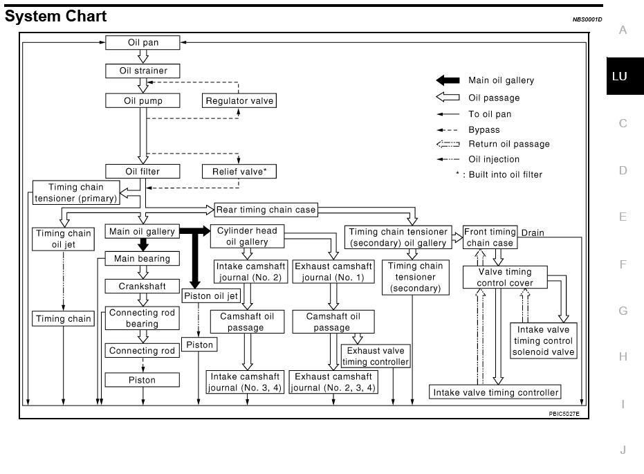

Old Jul 5, 2009 | 07:03 PM
Peak350's Avatar
Peak350
Posts: 1,844
From: DeLand, Florida
Hope this helps. I'm about to crash on ambien, but I think more or less, the answer is that there is a relief valve in the filter, a very high pressure relief valve if I had to guess.
Old Jul 6, 2009 | 05:39 PM
usgpru27's Avatar
usgpru27
Joined: Nov 2008
Posts: 163
From: New Jersey
Sorry about the Ambien.. I work for Sanofi-aventis and we make Ambien.. So your diagram answers my questions and if correct that high pressure would bypass the relief valve on the filter.. I need to get this figured out. Will see my master mechanic at my dealer to see what he knows.. Thanks for the great diagram!!

Edit, and to answer, I think its basically a valve that snaps open should the oil filter get clogged. It might open at 140 psi (and just get stuck open) so that you get slightly dirty oil in the engine, instead of no oil at all.
I've got an oil filter sitting in my garage (used) and I'll cut it open in the name of science/distruction.
