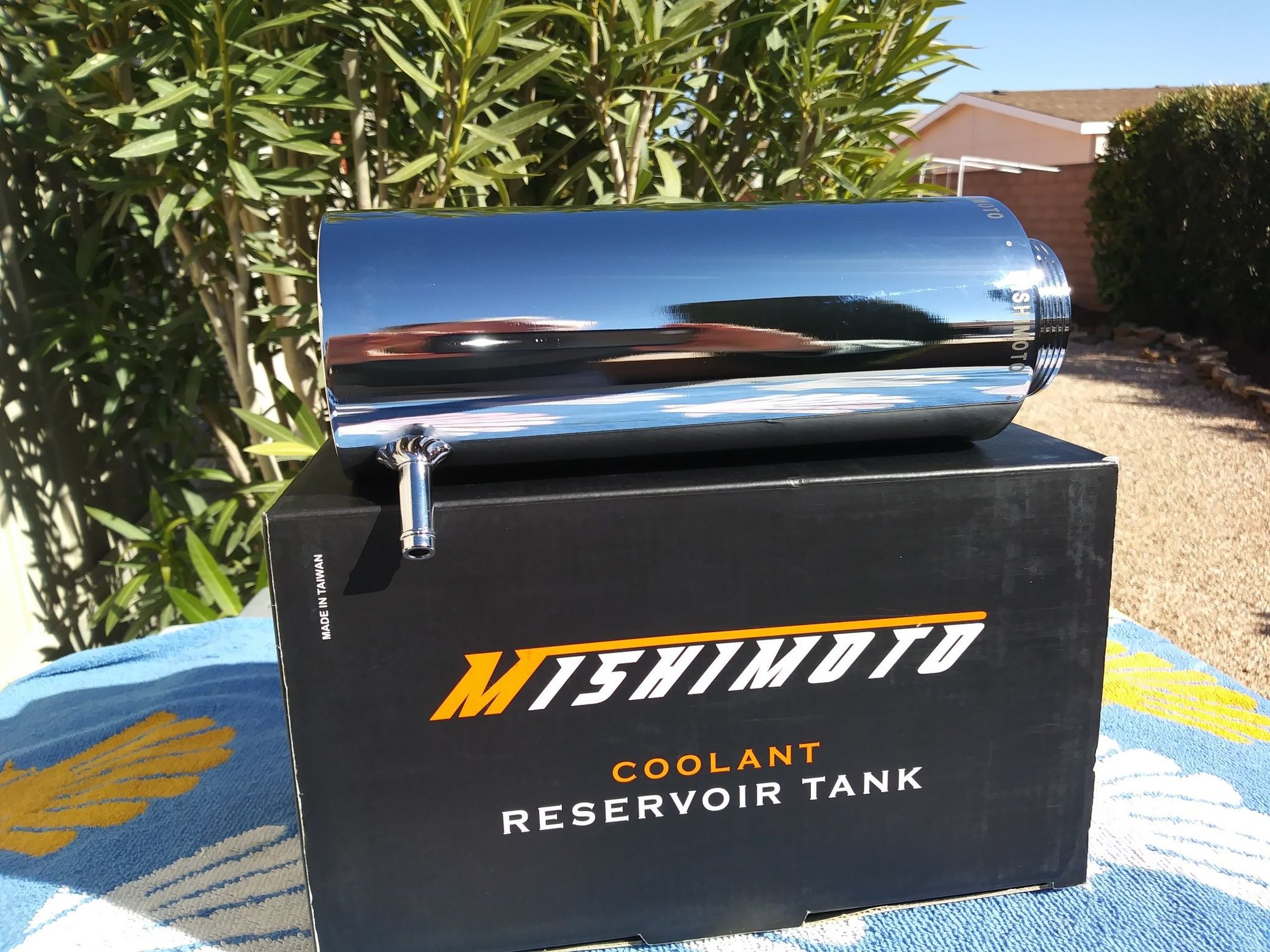

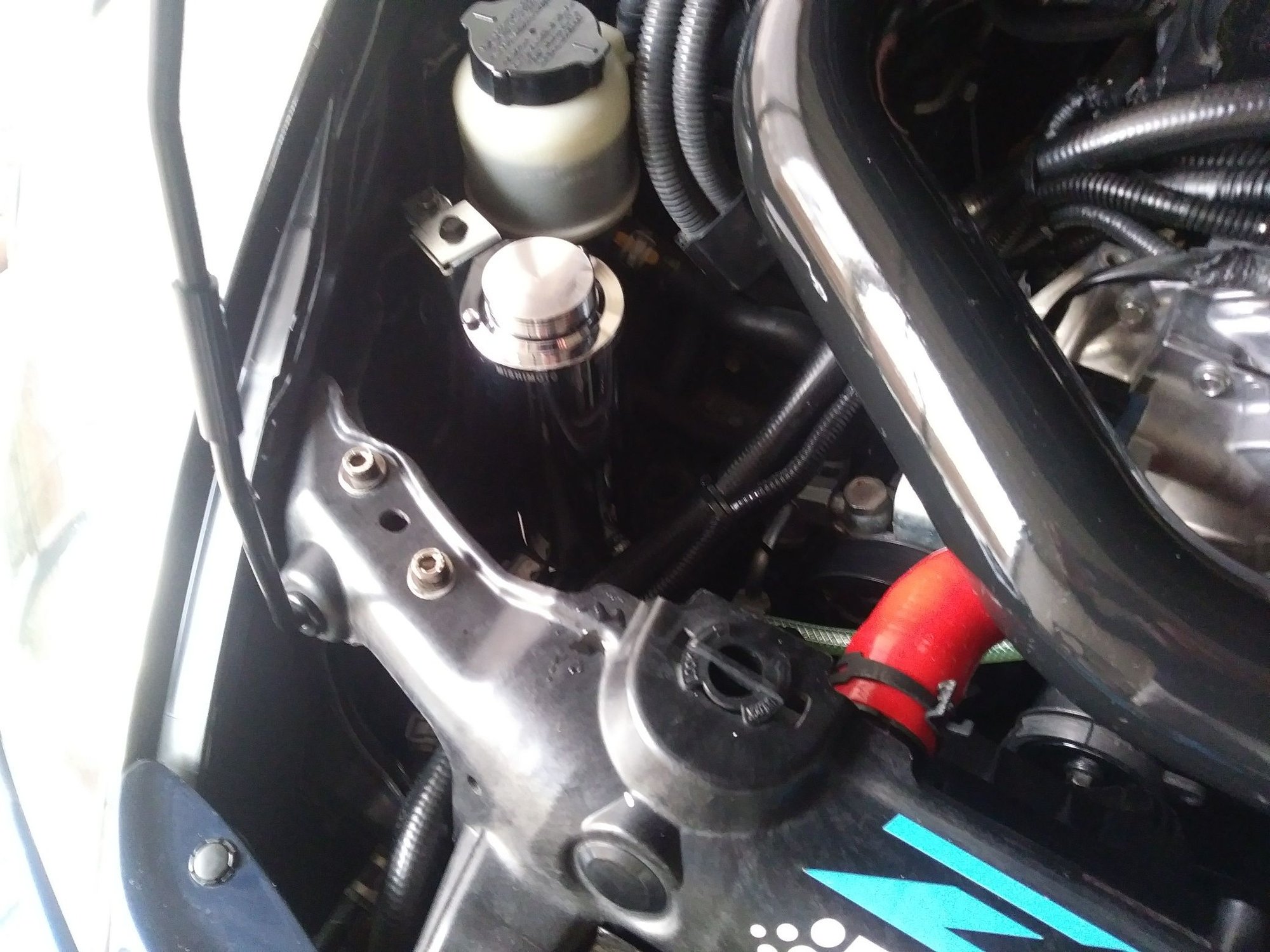

I installed a new polished aluminum (8"x3" dia.) Mishimoto radiator overflow tank; got rid of the crappy little plastic unit that came with the Stillen sc kit. I think it looks good and also clears out some space in that area! Would recommend this type of "metal" tank over the plastic!

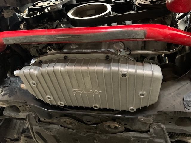

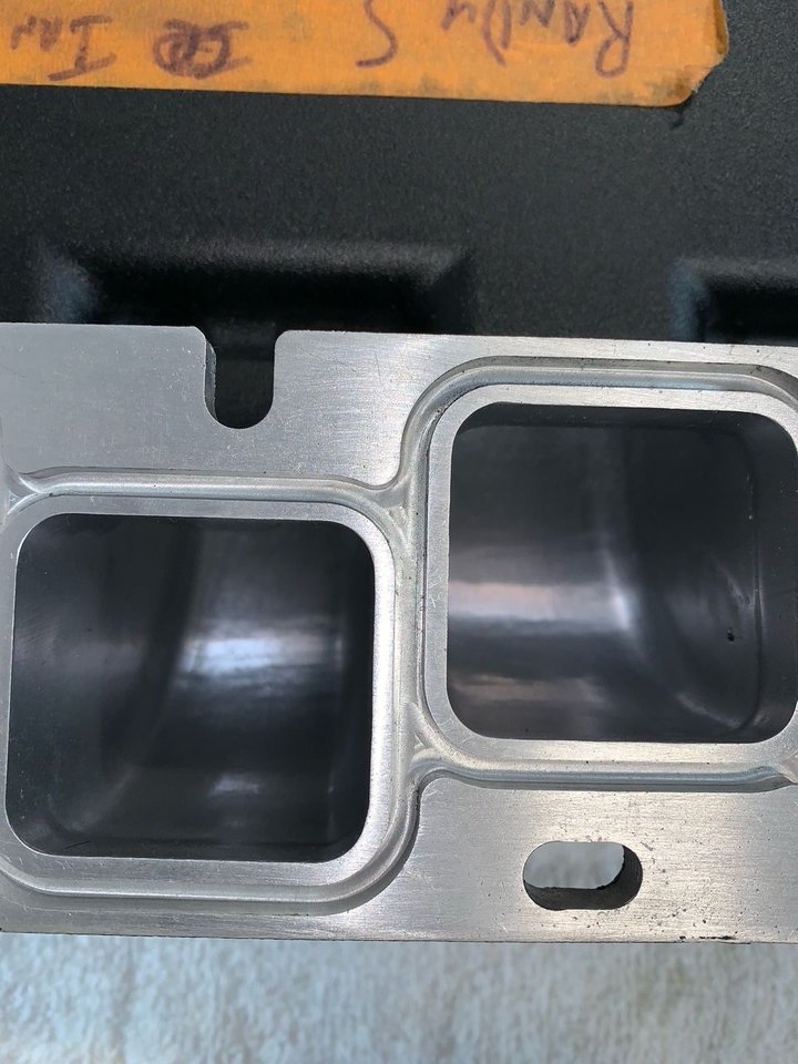

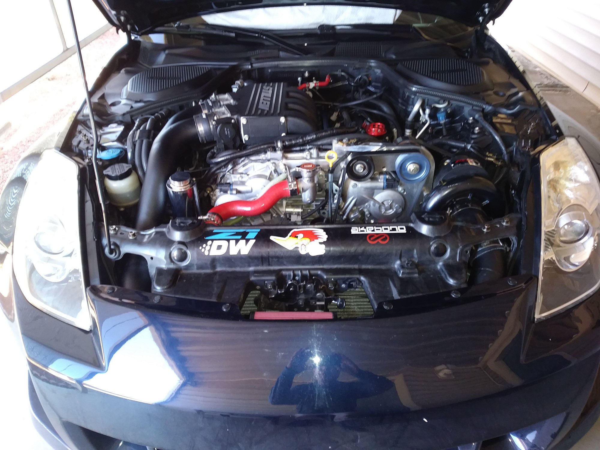

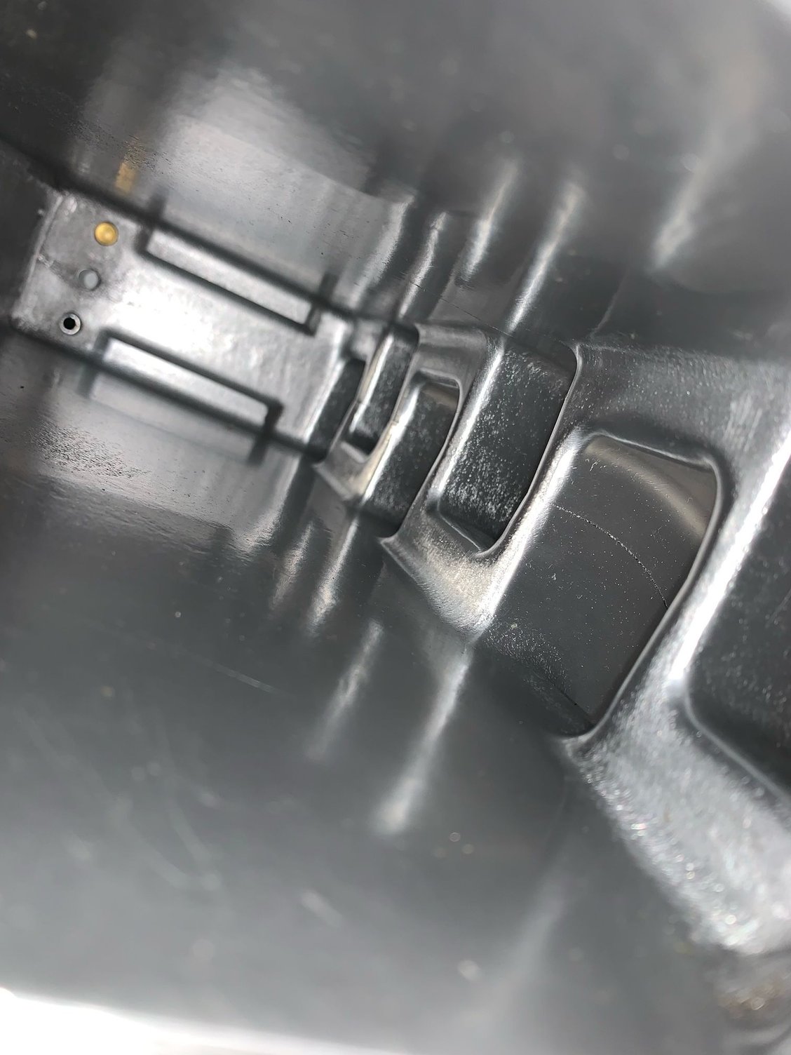

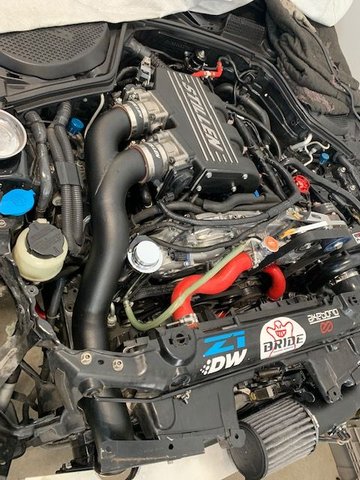

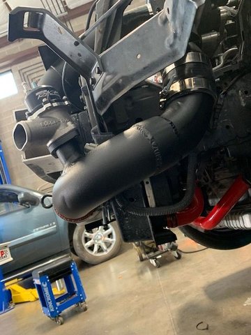

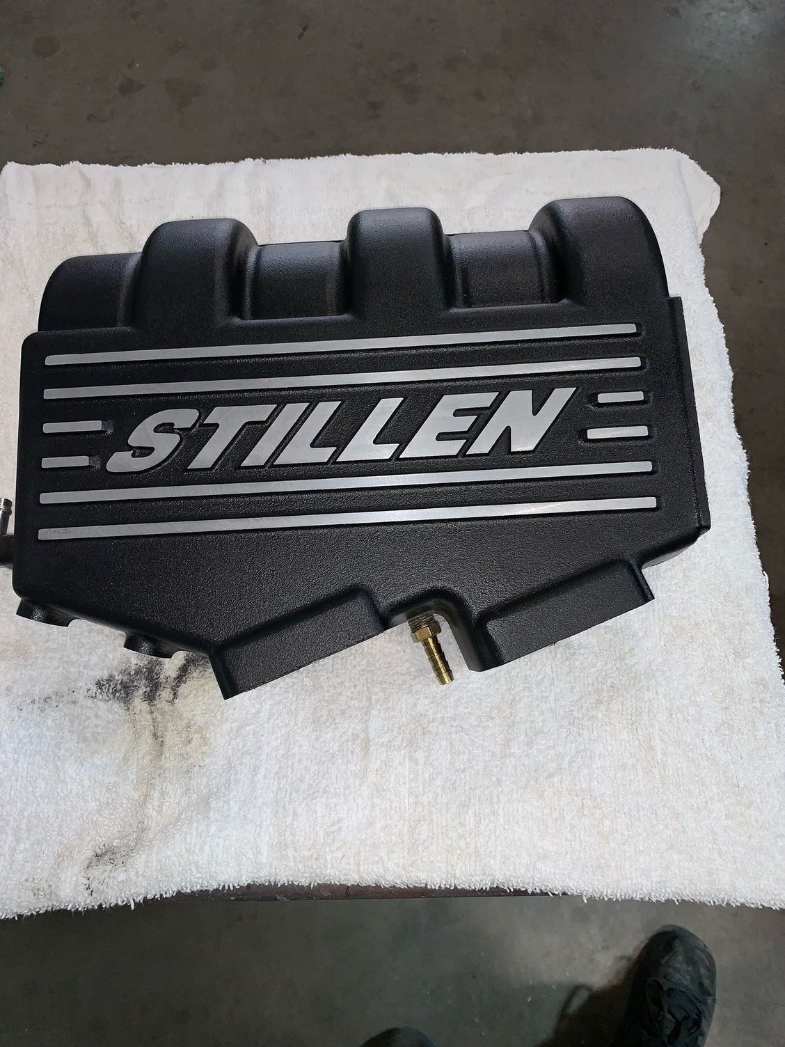

I recently had some nice things done to my car and once I get it all dialed in with my Tuner the little sucka will rip stronger than ever before. I got the car in to a custom shop where the owner has built several race cars and plenty of street demons; very meticulous and highly skilled. I had the Stillen V3 SC kit on the car (air to water system) and only kept the aluminum upper intake manifold plus the Si trim Vortech blower that had to be re-clocked in order to get the 3" piping to it.
He removed the upper and lower intake manifold and sent it to Extrude Hone in Cali. to be fully "Flow Ported" + Polished; they removed .026" of aluminum throughout the two parts and they did an awesome job; looks smooth as a mirror. Should flow much more intake air. He removed the Stillen heat exchanger and installed a Mishimoto intercooler, plus a Vortech race bypass/bov, Greddy 6 qt. oil pan, Z1 high energy coil packs + Denso iridium one step colder plugs. He had to figure the piping out to be able to custom fabricate all of the piping and custom brackets, etc, then powder coated it all to match the upper intake manifold.
Been doing some uprev data logging for my tuner and we have a way to go, but I can already tell that this new mod project will rock. Of course did new coolant, oil change (Mobil 1 full synthetic), AEM dry flow air filter. *I'd recommend that any of you guys that have the Stillen SC kit on their Z or G to seriously consider doing a similar air to air setup! You can see the fine polish inside of the upper manifold looks like a polished little room. PICS:

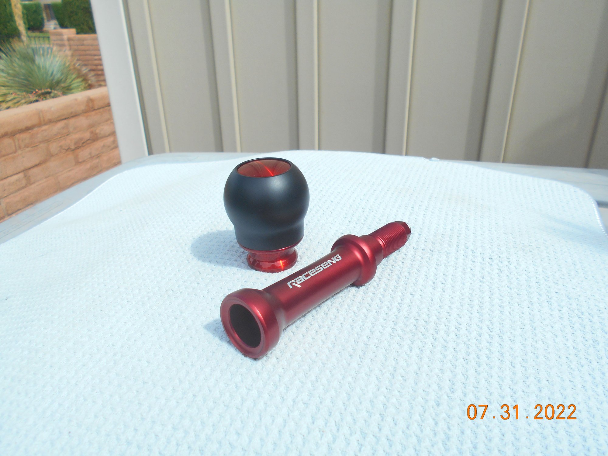

I got this new Raceseng shifter extender plus their "sphereology" (1 lb.) shift ****. Easy access to the shifter from the steering wheel and it pops into gears very easily and quickly. Good quality company.

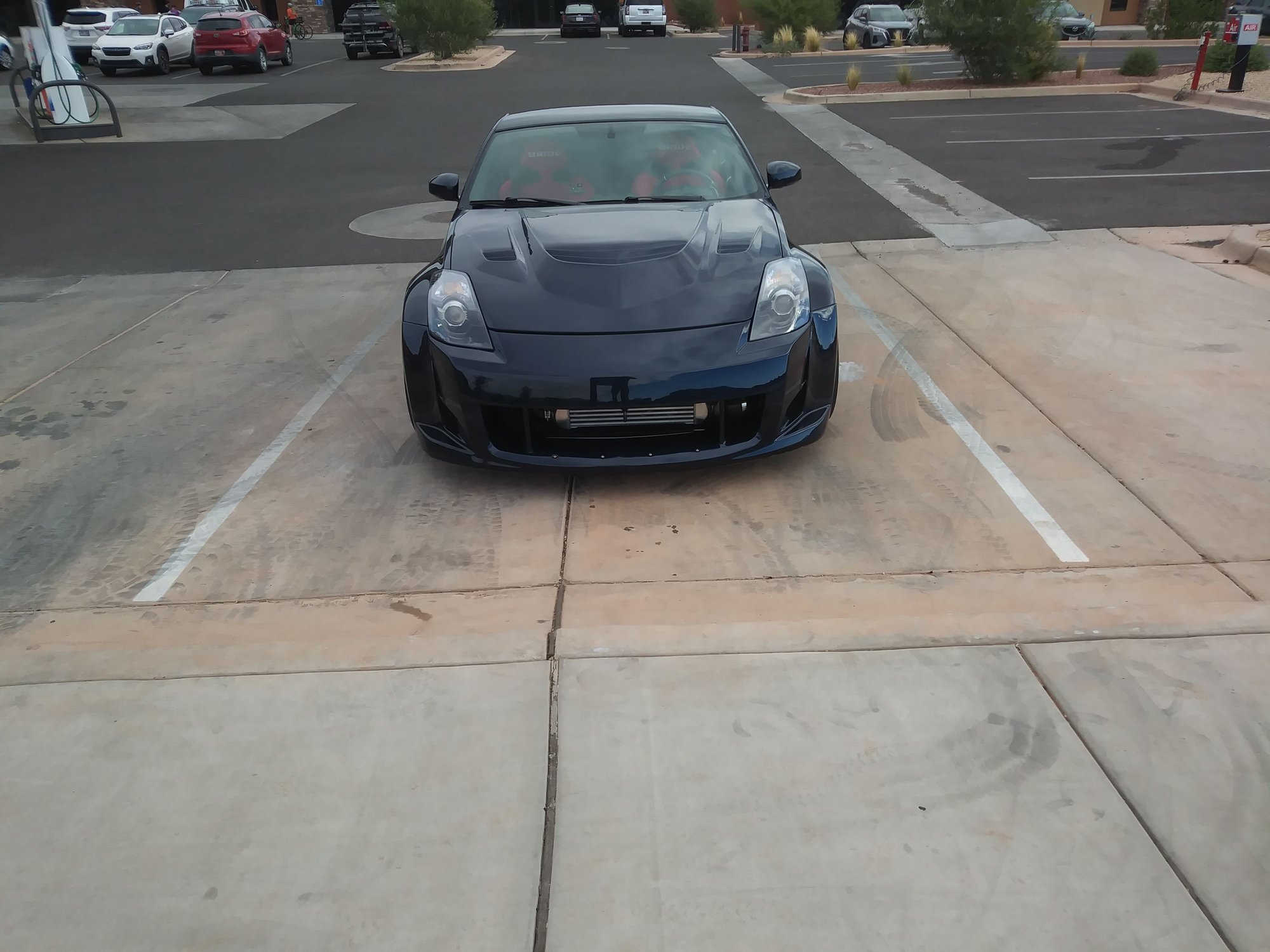

I got these darkened headlight assemblies today from Z1. I'll post before/after pics after I get 'em installed.
Old Oct 22, 2022 | 07:08 PM
  #353
BigBlue's Avatar
BigBlue
Joined: Feb 2013
Posts: 1,821
Likes: 188
From: Southern Utah

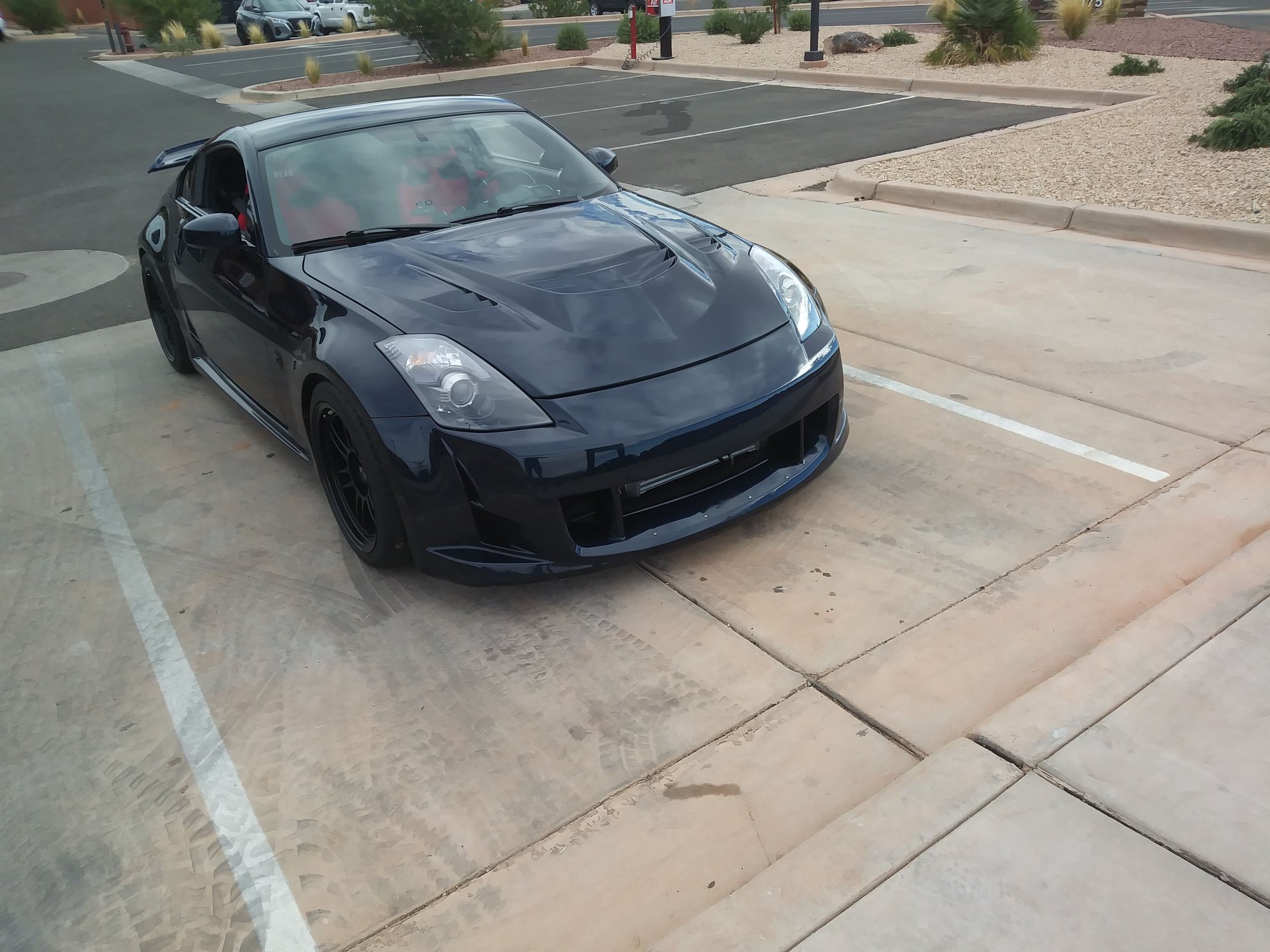

I installed the new darkened headlight assemblies (got Xpel clear bra done on them first); took the car for a spin today and snapped these pics:
*Just happened to receive a new tune sent to me just last night; flashed it on this a.m. and the Z is running like a champ; strong and way quick!

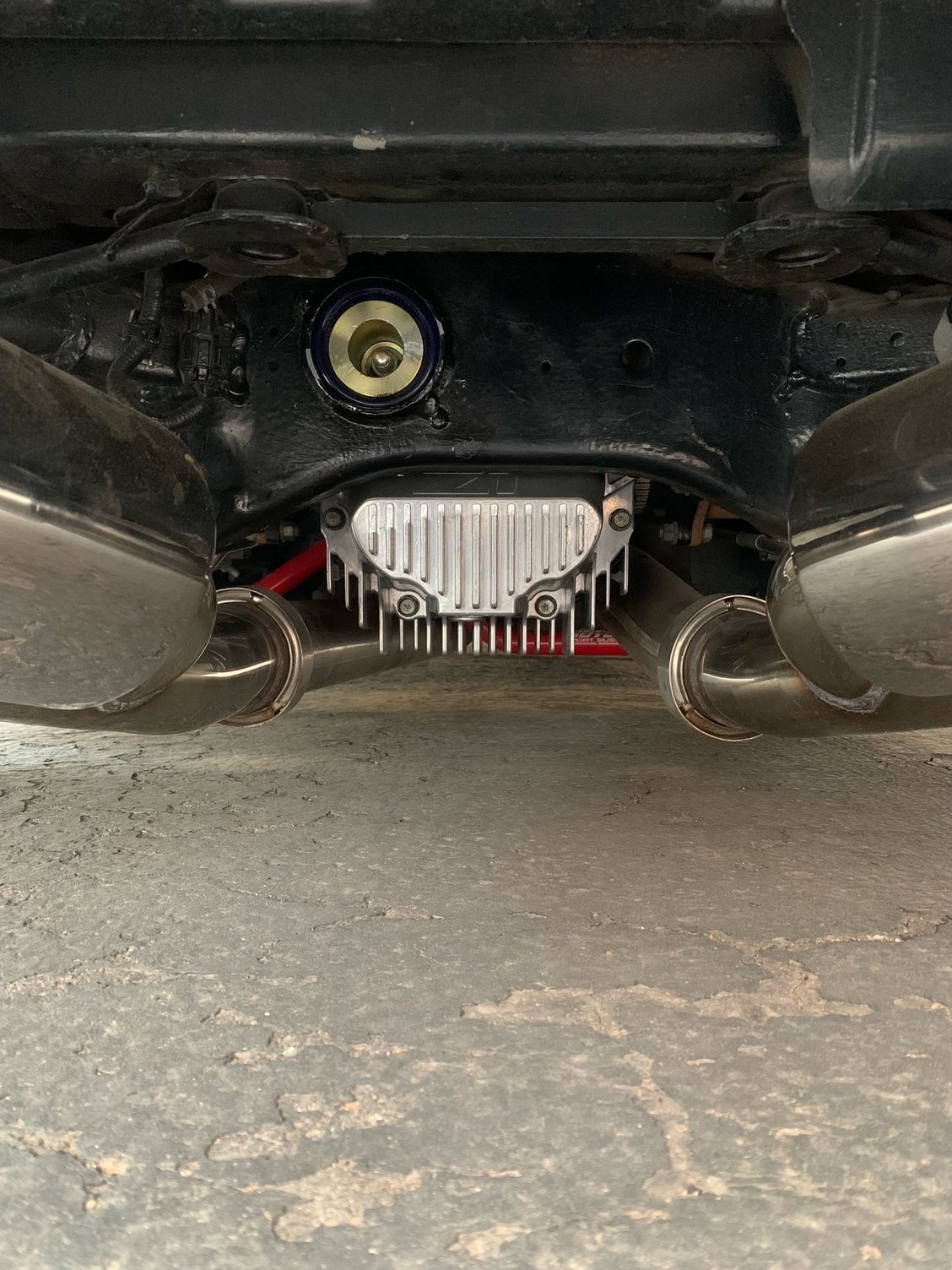

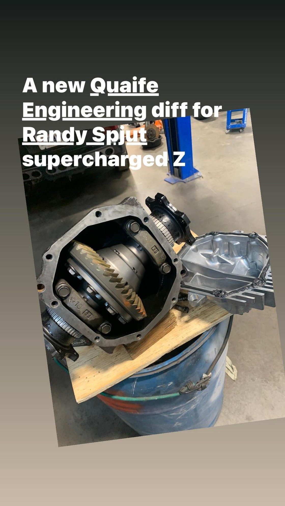

I bought a fully built differential kit from Z1 Motorsports and just got the car back after the swap. New setup has taller 3.69 fd ring and pinion gears; up from the 3.9's that I had; more speed per gear now, all new bearings, seals and urethane bushings along with a finned high capacity (3 qt.) rear cover, plus a Quaife LSD differential. This changes my gear ratios and puts 1st gear back into play. I'm digging it just in 1st day of testing! Something I've wanted to do for some time now and glad to have this done.
