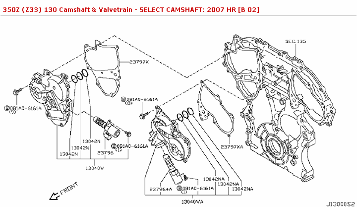

Can someone just post a picture of them on the vq35hr. i have spent another day searching for them on my car and still have had no luck. they are not in the same spot as the de.

I'll see if I can post a picture of them from the Electronic Nissan service manual.

Rancor is right, bad solenoids would not cause low oil pressure. Neither would those mods. The solenoids almost never go out on their own. If your oil pressure is that low, you really do need to stop driving it.
I circled their location. I'm starting to think your rear cover is leaking internally... you're gonna throw a rod or spin your main bearing dude.. honestly, most of the time I see what your car is doing, I end up having to replace the motor.

very good info, thank you. and thank you Jimmytherustler. don't worry the car hasn't gotten more than 10 miles since it started happening, and that was all just testing going up and down my road as we were trying to fix the problem. So i guess i'm just gonna have to take it to the shop and check that gasket inside the timing cover since i don't have a garage or indoor shop to do the job myself. cheaper than buying a new engine i guess
