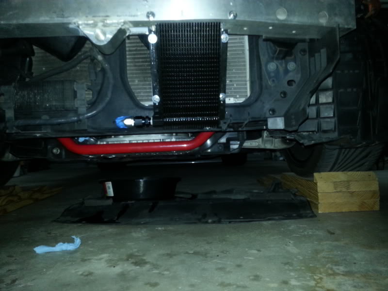

Well I no longer have my uprev setup after being fully dyno tuned on e85.
We figured out the problem while on the dyno:
My oil cooler is located on the driver side approx 3" in front of the air filter .
Engine was sucking hot air and pulling timing. A piece of cardboard to block the hot air flow instantly brought timing back up.
Next time I clean the air filter's I'll fab up an aluminum duct to get the hot air around the filter.
