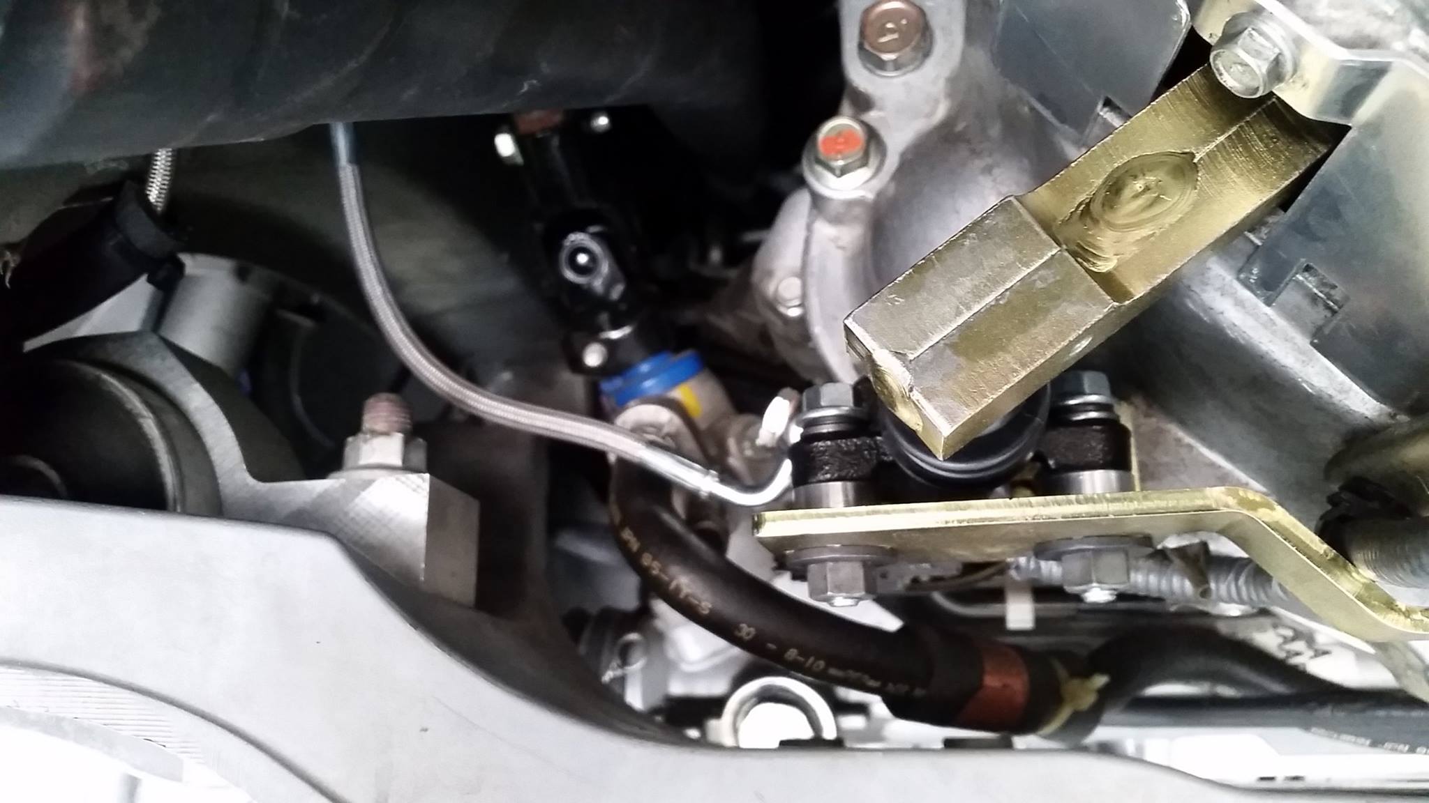

The build quality of the system great. All brackets are zinc coated. The clutch fork is so mean looking. It’s not going to ever give up on you. Install Pics include.

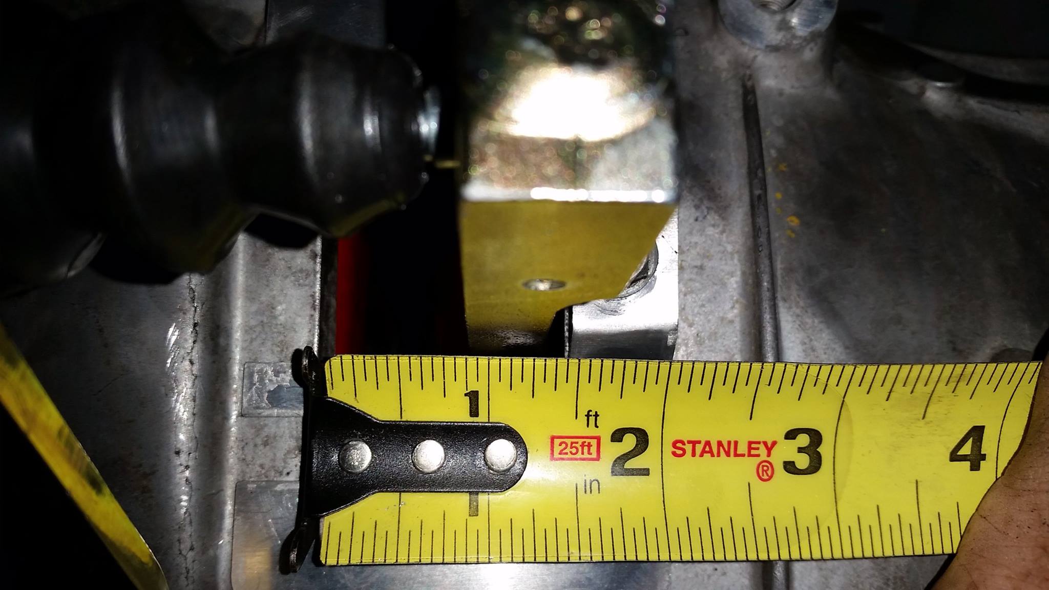

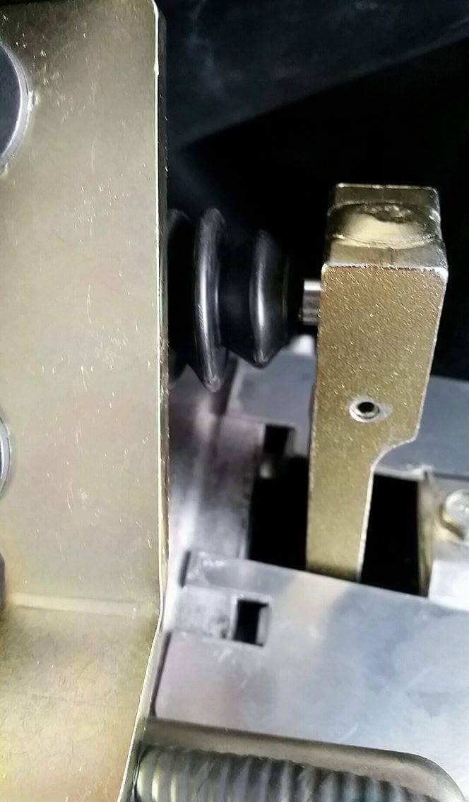

As for adjustments. Not really any needed. Just make sure the Slave it centered on the fork. (Pic's 9, 10, 11) You can spot this by looking at the boot the Slave. I have a Pic show it wrong and one with it right. There is a little wiggle room for this on mounting bracket for this small adjustment.
Bleeding the CMAK external slave unit was EASY compared to the CSC. Took less them 10 min and we had a full pedal. We flushed the entire system. Let’s just say it moves some fluid.
