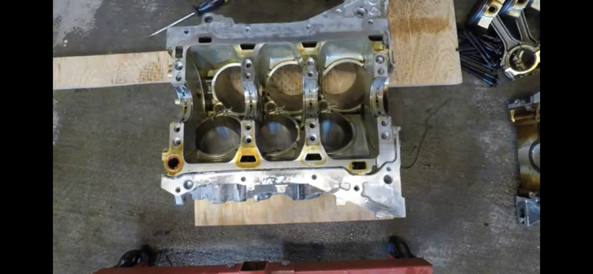

I had thought that if I purchase an HR rather then the VHR the stock HR pistons are bedded to that block, and I could avoid having to get new rings and hone the sleeves. Furthermore, that brings me to the head gasket question I had asked originally. I'm unsure if the previous people who have put the VHR crank in the HR block were using stock HG or not? Also, I am not familiar with the HR engine enough to know if pistons can be installed from below, saving having to pull the heads. This can be done on some engines, but I don't know about the HR
I dont think the pistons can be installed from the bottom side … I think theyre drop-in and connect to the crank … I am almost certain the girdle would interfer.
I think your best bet is buy a VHR and find HR heads … that’s what the people that I know have done. I dont think you use the HR block … I think you only use the HR heads/cams/valves/etc …
Yeah had a closer look at the HR/VHR blocks. Castings for the girdle support structure wouldn’t allow pistons to be installed from below. So the heads are coming off no matter which block I start with. Since that is the case, I think I agree with the above. Prices for used VHR’s are the same as HR’s, and I can probably pick up hr heads and pistons, for less then the VHR crank and rods.

Are the pistons the same between the HR & VHR?
If it was me, I’d find a good/great condition VHR with good compression, no issues and leave it alone. Remove heads, new head gaskets, head studs, and put the HR heads on the car.
I wouldnt economize on the VHR block - buy a really good one, even if it cost you more money upfront, then find clean HR heads … just my 2cents
The HR pistons have to be used to clear everything. The VHR pistons don't work with the HR heads.... or so I am told from a few different sources.
Here is a good video showing the 3 style pistons. The VHR pistons do not have valve reliefs on both sides of the piston face like the HR pistons do. I believe that the wrist pin height differs between them as well. There is also a difference in rod length between the HR/VHR

You may want to research it a little bit … messaged my buddy who did the VHR/HR hybrid and he said he used the VHR block and VHR internals… so maybe some mis-information and you’re making it harder than it needs to be. Proceed accordingly!
It is VHR crank and rods with HR pistons. VHR and HR blocks are the same.
