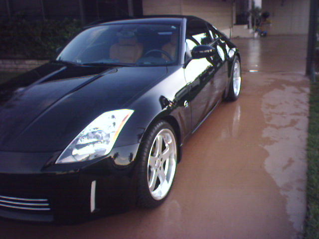

z boy, i snapped a few pics along time back before i lowered my z. sorry about the crappy shots, i used my cell ph camera...this will give you an idea of where my wheels sit in relation to the fender. your front will be in the exact location while your rears will barely sit out further than mine......
front:
Attached Thumbnails WHEEL / TIRE STAGGER on VDC cars (PICS included)-fr-sd.jpg

you can also get an idea of how the 245's fit a 8.5" wheel & how the 275's fit a 9.5" wheel. the 255's will look bulkier than my 245's & the 275's would look a tad less bulky than what you see on mine. im pretty happy with the overall fitment with tires & offset though! hope the pics can help as well........
-justin

two words: suh weeet!!! Looks awesome, Justin.
Thanks again for all your helpful input. You are a true gentleman and scholar.
