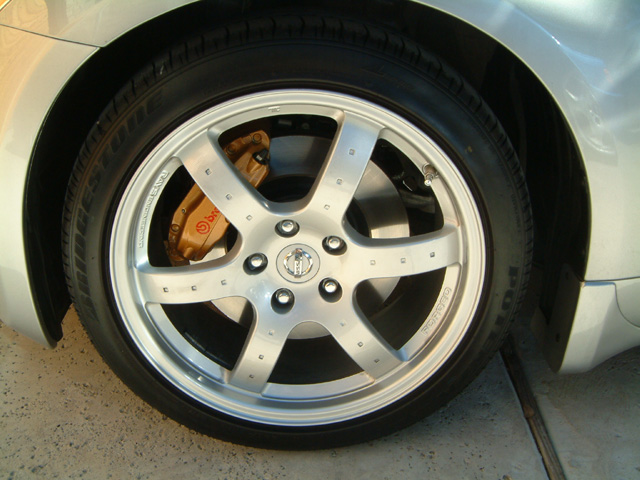

Does anyone know the offset for the front and rear wheels on the 350Z?

Depends on your model:
Option 1 - 17" - 17x7.5 +30mm (F) & 17x8.0 +33mm (R)
Option 2 - 18" - 18x8.0 +30mm (F) & 18x8.0 +30mm (R)
Option 3 - 18" Rays - 18x8.0 +30mm (F) & 18x8.5 +33mm (R)
Enjoy
