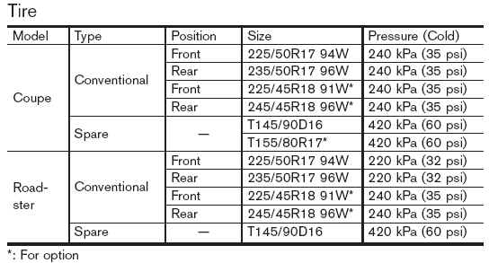

I have a 2004 350ZR and have a basic question about tire pressure. I have bone stock 17" rims and was wondering what tire pressure to inflate them to. The label on the door jam gives the pressure for 18" not 17".
Anyone know the proper pressure?
Is the front pressure the same as the back ones?
Thanks
Netko350Z

Read your user's manual that came with the car and it will state what psi to run. Almost all of the wheels are 32 psi front and back, but I think a couple might be different depending on R or not R.

The owners manual says to refer to the sticker on the door jam.
It gives info on 18" not 17"

35 psi cold in 17s

Thanks I think the 18" were at 36psi

Try the Technical info section of your manual....

woopsie I guess I never saw that!!!
