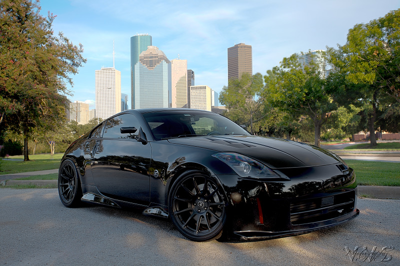

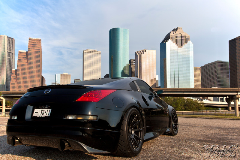

Most updated photos...
HRE P43SC
19x9.5 +20 19x11 +25
Toyo R888
265/30 & 305/30
KW Variant3 w/ SPL Front & Rear Camber Arms.

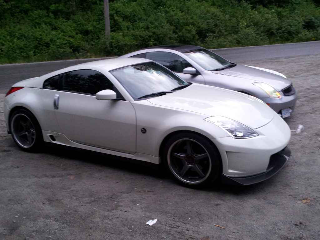

heres an image of my car not a great one of the tires but all i had at the moment now i geuss my second question is 305 30r19s or 295 35r19?
295/35/19 will be a better choice, 305/30/19 is pushing the limit.. you will need conservative offsets and rolled fenders to fit 305

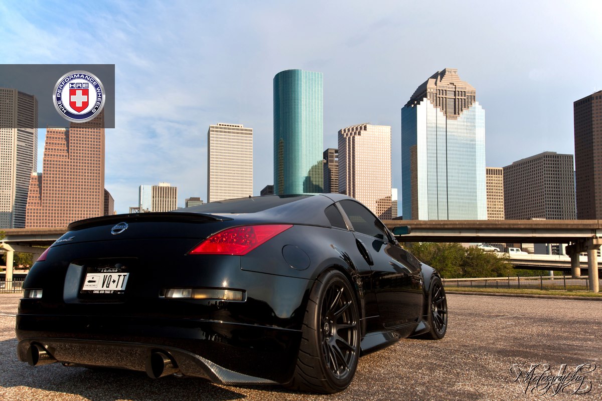

Attached Thumbnails 19" Wheel & Tire Discussion Thread-191891_10151094130716698_450354779_o.jpg
Old Sep 5, 2012 | 09:22 AM
  #875
Michla22's Avatar
Michla22
Posts: 551
From: Kyle, Tx
Work Gnosis GS2
F19x9.5 e17
R19x10.5 e15
Dunlop F245/35 R275/35
