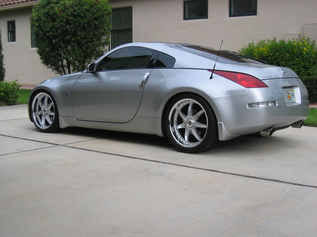

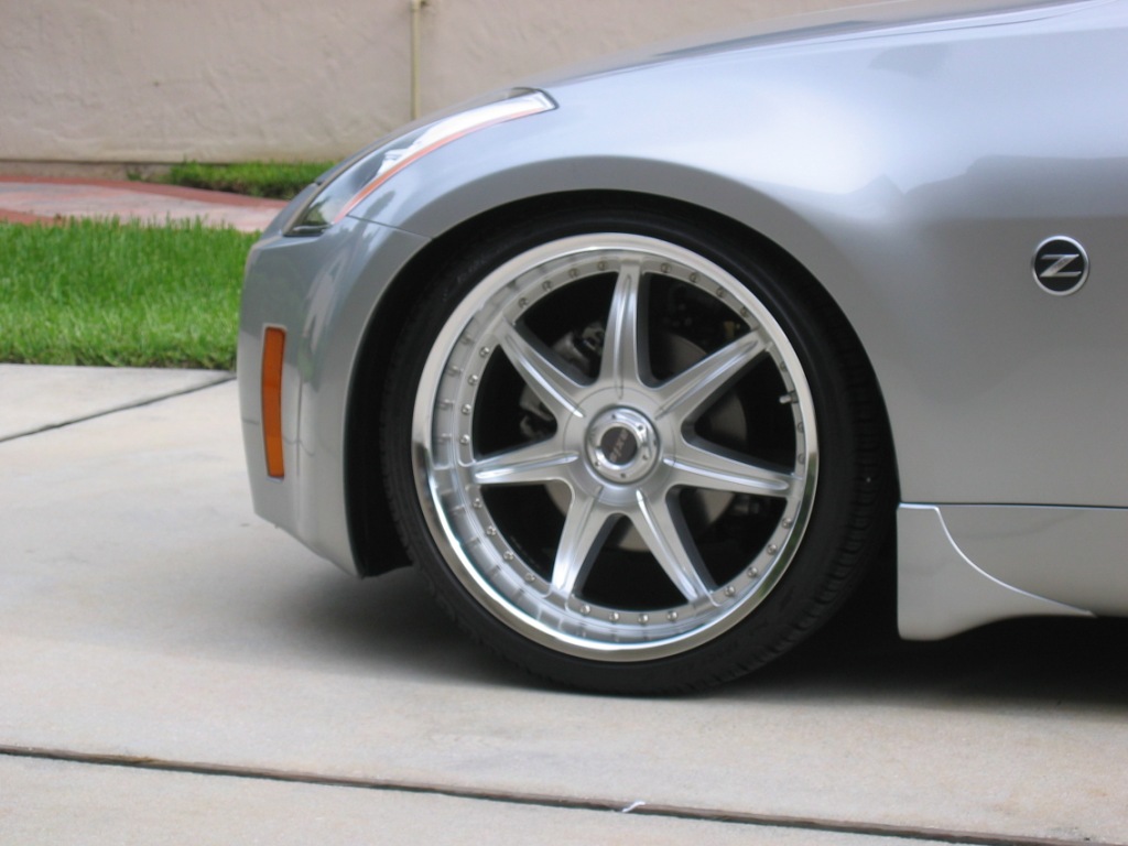

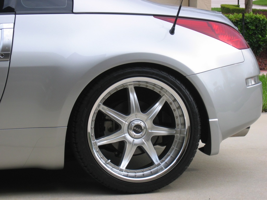

I went with 285/30s on 20x10 rims and no fender roll necessary. I'm assuming you're asking about the rear wheel/tire setup. I also just lowered it about 1" with TEIN Basics and still no rubbing. See pics.

Rim width range for a 285/30/20 is 9.5"-10.5". 285 is max for a 9.5" rim.
