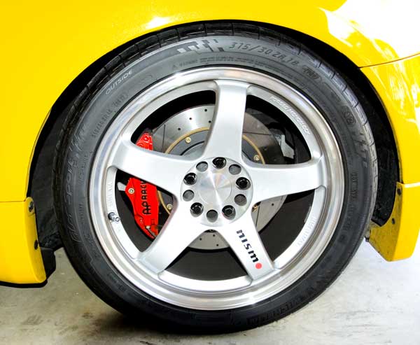

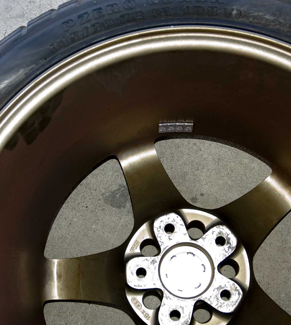

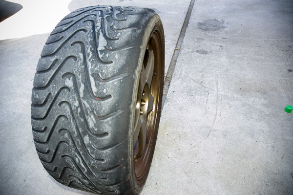

Man,......we do it all the time.. ....on lowered cars!. Here is a pick of a 315/30/18 on a 9.5" Nismo rear wheel and one of our Perelli Corsa's (same size) that we put on vision619's car.....Like I said NO PROBLEMS!!
