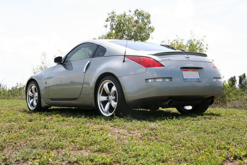

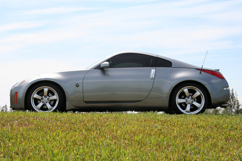

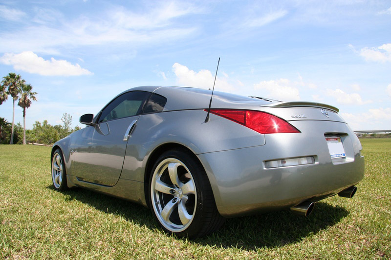

Just got them mounted on my car...2003 Touring....for those of you curious how they look.
I also weighed the stock touring vs the new track rays and here are the numbers:
2003 Front:
rim size = 18x8
tire size = 225/45/r18
weight = 52.4 lbs
condition = ~50% tread left
2006 Front:
rim size = 18x9
tire size = 245/45/r18
weight = 49.7 lbs
condition = less that 500 miles on them
2003 Rear:
rim size = 18x8
weight = 51.8 lbs
condition = No tread, smooth as a baby's butt.
2006 Rear:
rim size = 19x10
tire size = 265/35/r19
weight = 54.4 lbs
condition = less than 500 miles on them

What percentage of tint do you have all the way around?
Old May 21, 2006 | 02:50 PM
danlee1's Avatar
danlee1
Posts: 158
From: Ft Lauderdale, FL
I'm not sure the percentage, but it's whatever is legal on the rear doors of sedans in FL (basically making it slightly not legal).

The weight saving in the front is 3 pounds.
And the rear wheels are 3 pounds more heavy.
Is that correct?
Old May 21, 2006 | 04:28 PM
danlee1's Avatar
danlee1
Posts: 158
yes. I attribute that to the larger tires, wheels, and the fact that there is more tread left whereas the old rears were bald. I think the tread constitutes a good portion of the weight with respect to the total tire weight. Dan

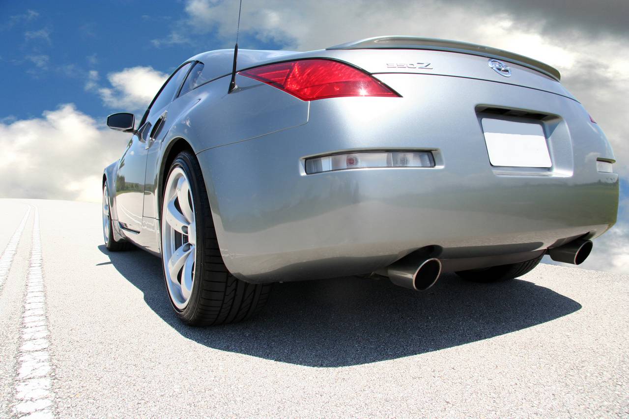

Default One more pic
Signature in process....

You wouldn't happen to know the offset on each of these wheels, would you?
Old May 21, 2006 | 08:05 PM
danlee1's Avatar
danlee1
Posts: 158
I retract my previous comment on the differing tread patterns...looks the same front and rear. I didn't notice the continuous block on the rear until just now.
Regarding the offset, I have absolutely no clue except the wheels fill out the fenders nicely. Looks to be some room for much wider tires in the rear.

Still trying to figure out why they went with a 265 in the rear... 275/35-19 is the correct size to match the stock ratios, what nearly everyone who upsizes rear tires uses and what Nismo reccomends for their LMGT4 rims.
Old May 30, 2006 | 06:05 PM
danlee1's Avatar
danlee1
Posts: 158
They probably chose the sizes to eliminate some of the understeer (or push for you nascar fans) that the car naturally exhibits with the standard sizing. i haven't taken this particular setup on the track yet so i can't confirm, but it only makes sense.
