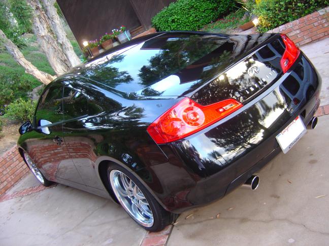

Don't know what look you are going for, but with 40mm offset, your back wheels will have a "tucked in" look. Like ssk said, may want to look into some spacers. Good Luck
EDIT: Here is a member w/ a +40offset on his rear 19x9.5. wheels to give you an idea of the look.
