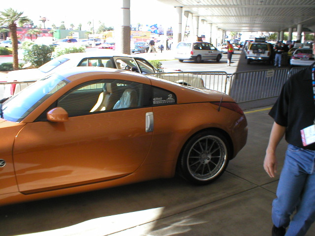

This car out at SEMA had 275s in front and 295s in back and looked AWESOME Tire rack lists 295/35/18s need at least a 10" rim but Im having a hell of a time finding any, I dont even know which ones these are, any ideas?

That's our SEMA car: special thanks got to Nissan, Eibach, StopTech, and Pirelli Tire North America... I put that car together in five days!
We used 19x9.5 front w/ 275/30-19 and 19x10.5 rear with 295/30-19 Pirelli P-Zero Rosso. Also, note that the car has the HRE 448R in charcoal on the side pictured above, and the HRE 445R in brushed/clearcoat on the other side.
In an 18", you could do something like Jeff (zland) did, with 18x9 265/35-18 front and 18x10 295/35-18 rear.
Happy hunting!!

wow! thanks for the post that wa sthe first car i saw walking into SEMA and it was set up jjust right, great job!
