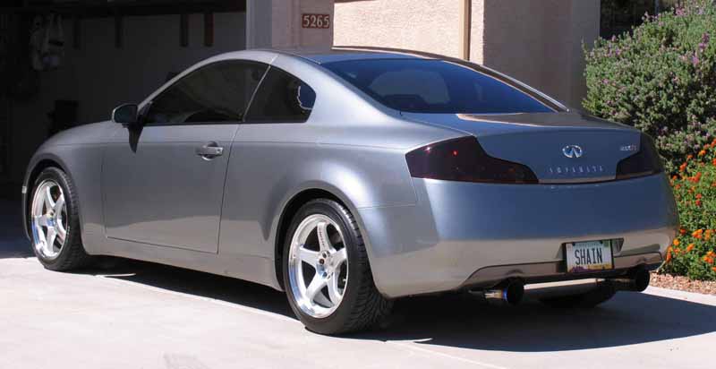

I think the choices Brick-Z recommended are in fact ideal. Some members have less offset in the back to push the wheels out further. 30mm, IMO, is just about perfect. In fact that's what Nismo uses for it's 9.5" rear wheel. They also use 25mm for their 8.5" front wheel. I have an 18" set, and think they are just about perfect.
