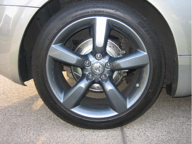

had my silver oem 18 inchers painted (GM4009 gunmetal)
