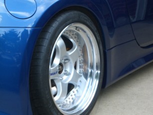

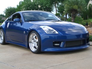

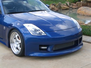

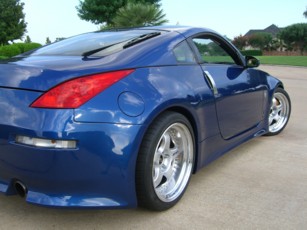

I just install 19 x11 Work Mister w/Michelin PS@ 19x295x30on rear & 19 x9.5 w/Michelin PS2 265x35 on front
I had a slight rub on the front coming up a driveway --I raised the tein supension anout an inch and so far no problems with rubbing. I was prepared to roll my fenders with the bat but so far so good.
Attached Thumbnails rubbing problem??-vertex-body-kit-and-mister-wheels-004.jpg   rubbing problem??-vertex-body-kit-and-mister-wheels-010.jpg   rubbing problem??-vertex-body-kit-and-mister-wheels-011.jpg   rubbing problem??-vertex-body-kit-and-mister-wheels-015.jpg
Old Jun 26, 2007 | 07:22 PM
Checkmate58's Avatar
Checkmate58
Joined: Nov 2005
Posts: 350
From: Bay Area
Your car doesn't look that dropped. Looks like there's like 2 fingers between the fender and top of the tire? Should be fine unless you decide to drop the car more.
