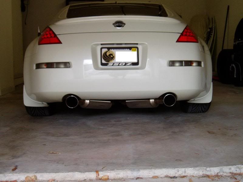

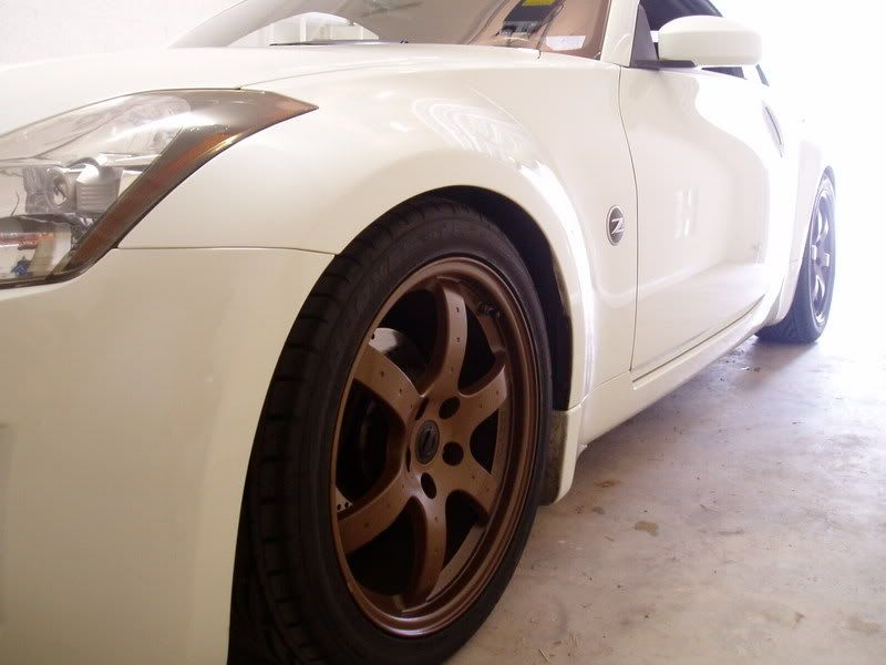

Im running almost the exact same wheel/spacer combo.....except im on eibach springs. So i was worried about a 265 rubbing in the back.
Im running a 15mm spacer in the F, and a 20mm in the rear. I just got 245/40 F and 255/40 R toyo t1r's.
If you dont lower it you can run a 265. Although most will say that is too much tire for the rear wheel. If you want to lower your car then you cannot run a 265.....i dont think. Im about as close as you can get with out rubbing right now. i think a 265 would rub.
The spacers really improve the stance. It makes a world of difference.

Do you think you would have had rubbing issues w/ 20mm spacers up front? (Believe your Eibachs lower the car more than my Hotchkis springs do.)
Any pix of your ride?

I think a 20mm will be fine in the front. You could maybe even do a 25mm. I wish now i went with a bigger spacer in the front....but oh well.
BTW the last pic was when i still had OEM size tires. 225/245
Old Jul 8, 2007 | 12:43 PM
twinship's Avatar
twinship
Posts: 304
Hella--
Thx for posting the pix. Looks good!
