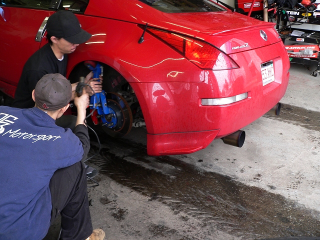

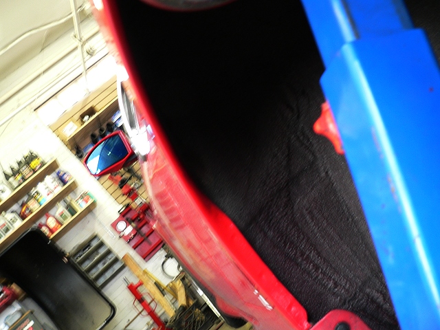

I found these
Attached Thumbnails Z is a sexy car,Volk's are awesome wheels, nothing is perfect, fender rolling issues-roll1.jpg   Z is a sexy car,Volk's are awesome wheels, nothing is perfect, fender rolling issues-roll2.jpg

From wayyyy back in the day-scroll down for pics of when I had mine rolled (before I started doing it)
https://my350z.com/forum/wheels-and-tires/133269-pics-limited-edition-gloss-black-le37-s.html
Pic of a Z I did AFTER rolling-no difference on the outside
Another thread where I rolled for a local member/friend, he posted pics...GOOD LUCK!
https://my350z.com/forum/showthread....fender+rolling
