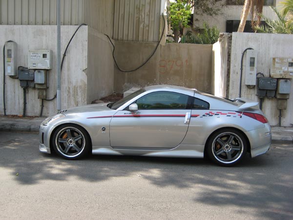

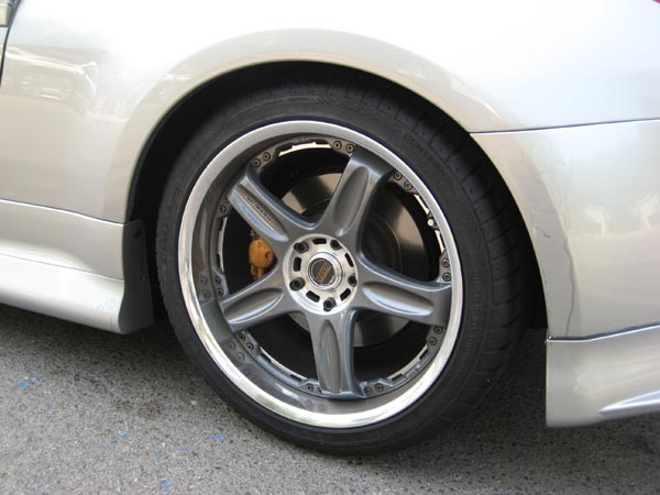

I will make this short.. I got those wheeles of some 1 who just installed them for 1 month on his car and I paid a cheap price for them.. the guy had ordered them not the right sizes nore the right ofset... I know they r 19/8.5 Front and 19/9.5 back don't know much about the ofset of those wheels...
they look nice but not so nice for a set of volk specialy after seeing how others look big tough and just there in your face... what can I do to fix it and how much it will cost me to order the rings if that was the only solution i can go with... Thank you.

put some wheels spacers in...they will make a HUGE difference

offset looks alil too high....20-25mm spacers will do the job without rubbing problems

I say measure. it looks to me like you could use a 10-15mm spacer... 20 is pretty crazy.
if you take off the rims, the offsets should be stamped on the inside.

ok so all of u think 'll be ok with a 10-15 mm spacer??
and do u think it will be ok on high speed? as in Safe?

why don't you find out the offset for us first?

yah, a set of spacers and good drop in the rear will make it look just fine. Just give us the offset and then we can figure out the right spacer.

From the looks of it, 20mm all around would improve a lot. If you stick with good brands, you really don't have to worry about anything highspeeds. Just make sure you get hub centric rings if those spacers are hubcentric already. Go with H+R , KICS, or Ichiba spacers. Don't buy cheap ebay crap.
