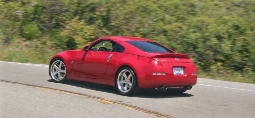

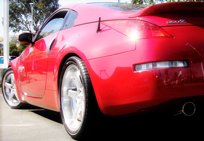

I know of at least one guy on this forum that is now running an 11" rear with a 305 I will dig up his name later
I'm sure you can run an 11" rim without it sticking out but a lot has to do with the offsets and size tires.
As a guide for you. I have 19x10.5" rears with 305/30/19's. the offset is 35mm. I had to tweak the fender lips a very very tiny bit. The inner sidewall grazes the shock boot but I mean just barely, almost no even worth mentioning. It starts to graze it, then over larger bumps, grazes it a tad more, then when the suspension compresses even more, it pulls away from the boot, probably because of the toe in changing more, as it compresses
I am running more negative camber that what I want. It corners awesome but they don't hook up for **** from a stop. If I put the camber where it should be with a 305, I estimate that the top of the wheel will be pushed out 1/2" closer to the lip and in turn the bottom would be kicked in 1/2". These were just rough measurements/estimates.
Right now they stick out as far as I would like and I don't want to mess with the fender lips anymore, so in the future I will step down to a 295, so I can dial out the excess camber.

Chad68's Avatar
Chad68
Posts: 3,171
From: CA
Lets see if this pic of my setup comes through. Unfortuantly it's not taken directly from behind.
Old Nov 11, 2007 | 06:49 PM
Chad68's Avatar
Chad68
Posts: 3,171
From: CA
Here's a few more angles
Attached Thumbnails Ok, about to buy these wheels.-lotsa-camber.jpg   Ok, about to buy these wheels.-side-view.jpg
