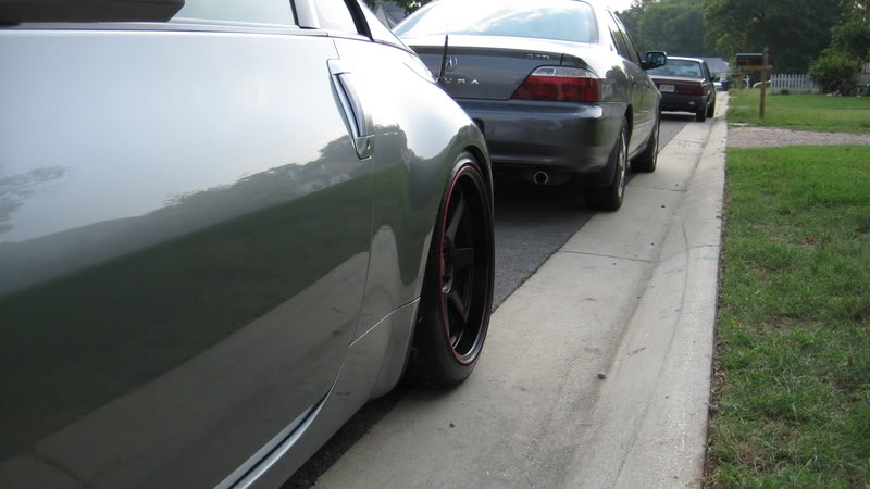

I just wanna post a quick pick I will be in this club as soon as I get a valid answer on what spacers I should order. My fenders are being rolled after christmas so i will have room to grow (so to speak)
I have the age old 9.5 F and 10.5 R +22 offset from Volk with 255/275 Toyo TR1.
****I need new rear tires so I was thinking Vrednesstein since they are nice tires and tend to run a little narrow so it could help with fender clearance****
any other recommendations would be great
So at my current height Eibach Sportlines what spacers can I run? I was thinking 10mm F and 15mm rear.
Suggestions? Pics? thanks guys

Do you plan on changing out the tires?
I personally would sell the wheels and buy new wheels to the specs you want... but if you want to save money I would run a 20mm spacer in the front with a 225/35 tire so effectively it will be 9.5 +2 in the front and in the rear I would run a 25mm in the rear with a 245 tire so you will sit with a 10.5 -3 in the rear.

Well the dont make Volks with offsets like that in the TE37 TA. I am not stretching the tire, just going as flush as I can with 255/275 setup. Can't put down 450whp with 215's in the rear

^^ then just do a 15mm up front and 20mm in the back. will fit with your tires.

If keeping your tires... do a 10 in the front and a 15 in the rear with rear fenders rolled.

+1 on 10 and 15

+2. My boy is slammed on coilovers with +8 TA in rear (15mm spacer) on 275/35/19, it tucks perfect.
