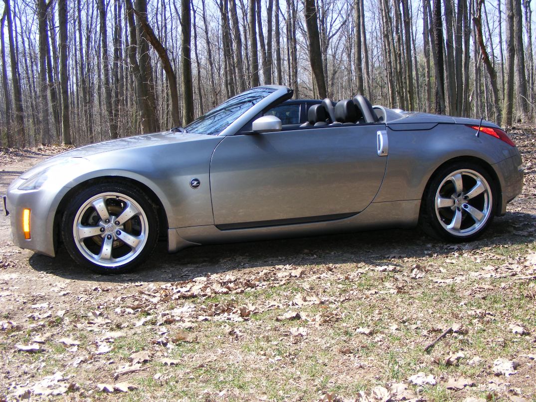

I just switched from the stock 04 18's to a set of the GT wheels 2 weeks ago. The ride is minimally rougher, but the handling overall feels much tighter. The other day I hit a pothole on the highway that I didn't even see coming on the front drivers side....felt like my head shattered, and my hand knocked me right out of gear....but the wheel/tire seem fine
Attached Thumbnails 18" front, 19" rear, GT owners and others comments requested-newwheels.jpg

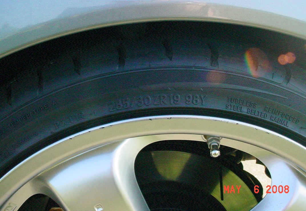

This weekend, I was able to fit 285/30/19 in the rear (with no fender rolling or cutting, but it's really close) and 255/35/18 in the front. My wheels are the oem forged rays that came on the car. 19x10 Offset +30mm rear, and 18x9 Offset +30mm front. I'm dropped on Hotchkis springs & sways.

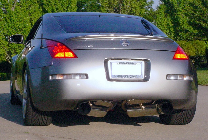

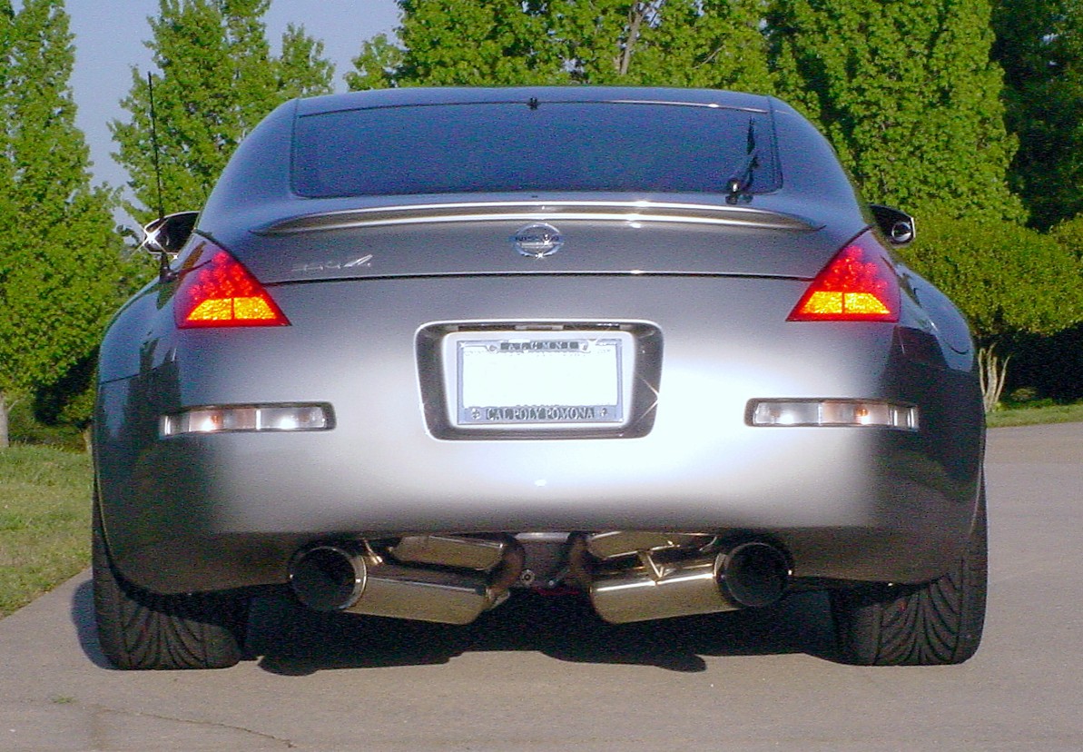

Here ya go...
285/30/19 19x10 Offset +30mm , and 255/35/18 18x9 Offset +30mm. Hotchkis springs & sways.
Also have a stillen rear camber kit on the way, installing this weekend. Camber as it sits now, is just a little out of spec. :-(
