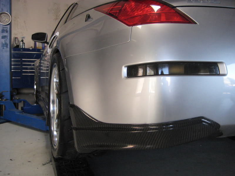

my R888s on 305/30/19 on 19x10.5 rim
https://my350z.com/forum/showpost.ph...8&postcount=34
Do you have any side pics ?
