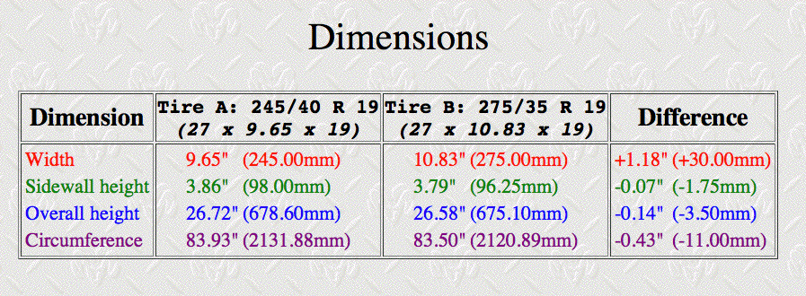

My question is on tire size. The recommended size is 245/35/19 front and 75/35/19 rear. the respective diameter is 25.8 front and 26.6 rear on both tires, which is the same as factory diameter.
If I go Michelin I was going to go 245/40/19 front and 275/35/19 rear. the diameter on the michelins are 26.4 for the front and 26.6 for the rear. this is only a .2 difference in tire height instead of the factor .8.
Would this give me any problem with TCS?

You are using a general guideline. Not all tires are the same. As for my research all 245/40/19 tires are about 26.7 in diameter, and the 275/35/19 are 26.6 in daimeter. The one exclusion is the Michelin Pilot Sport A/S in which the 245/40 is actually shorter than the 275. check tire rack or michelin on the tire specs.
