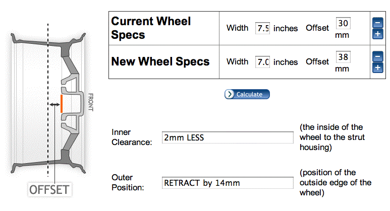

A friend is offering to sell me his winter wheels + tires he used on his G35 coupe.
All I need to know is, will these fit my 350z Enthusiast?
They are Enkei RS6 17x7 +38. Tires are 245/50/17 all around. The tires are ok, I'm just concerned about the offset of the wheels. Any thoughts??

Should be able to, unless you have a BBK.
G35 is basically the same.

Heres a comparison with the OEM 7.5 inch wheel.
