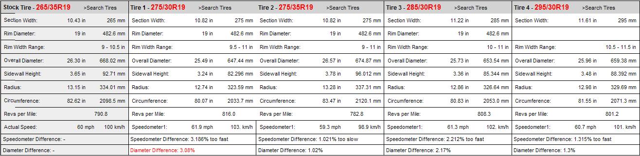

Need new tires and was reading up on posts from DavesZ and Kcobean on the tire ratio aspect issue with VDC operation.
My 07 GT has 245/40/18 in front and 265/35/19's in rear. I was searching to buy the Vredensteins for the rear but I don't believe they are manufactured in the 265/35/19 combination. If i understand the tire calculator correctly Kcobean posted then by using the next size- 275/30/19's will put me outside of the 3% margin causing issues with my VDC. It seems I am only able to use the 265/35's on the rear??

Does this help?
Attached Thumbnails New tires-aspect ratio/VDC clarity-tires.jpg

Yes it confirms I was previously using the table correctly. I guess I am just looking for real world experience from others. Also Not sure if the relationship of size differences from front to rear also has adverse issues using sized tires other than stock with the VDC?
