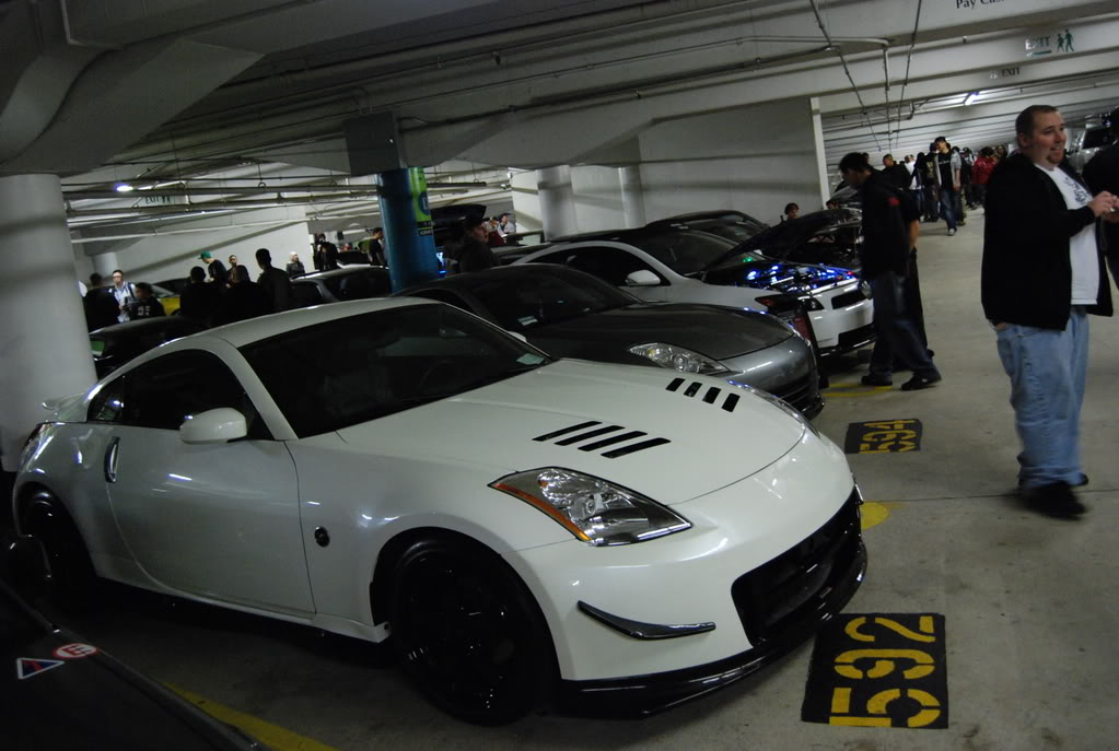

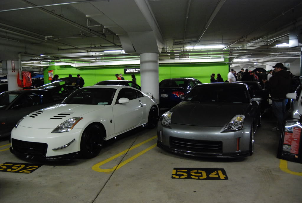

thank you.but can anyone help me whats the best tire set up for my 18 inch nismo lmgt4 wheels?im not sure whats my wheel offset are i have to check it out tomorrow.but anyway my tires on my rears are 245/40/18 alot of people are dissing my wheels and tires.is there anyway i can change my tires to make it look more aggressive or i have to get some new wheels?
heres a picture of my wheel setup.PPW

sorry if you cant really see it from this picture how the offset on my wheels are.check my photo album but its kinda blurry.thank you!
