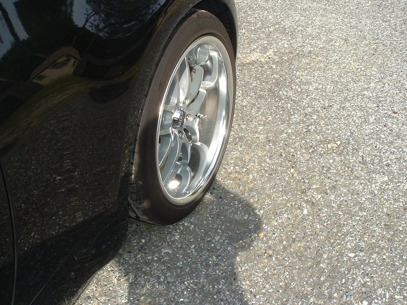

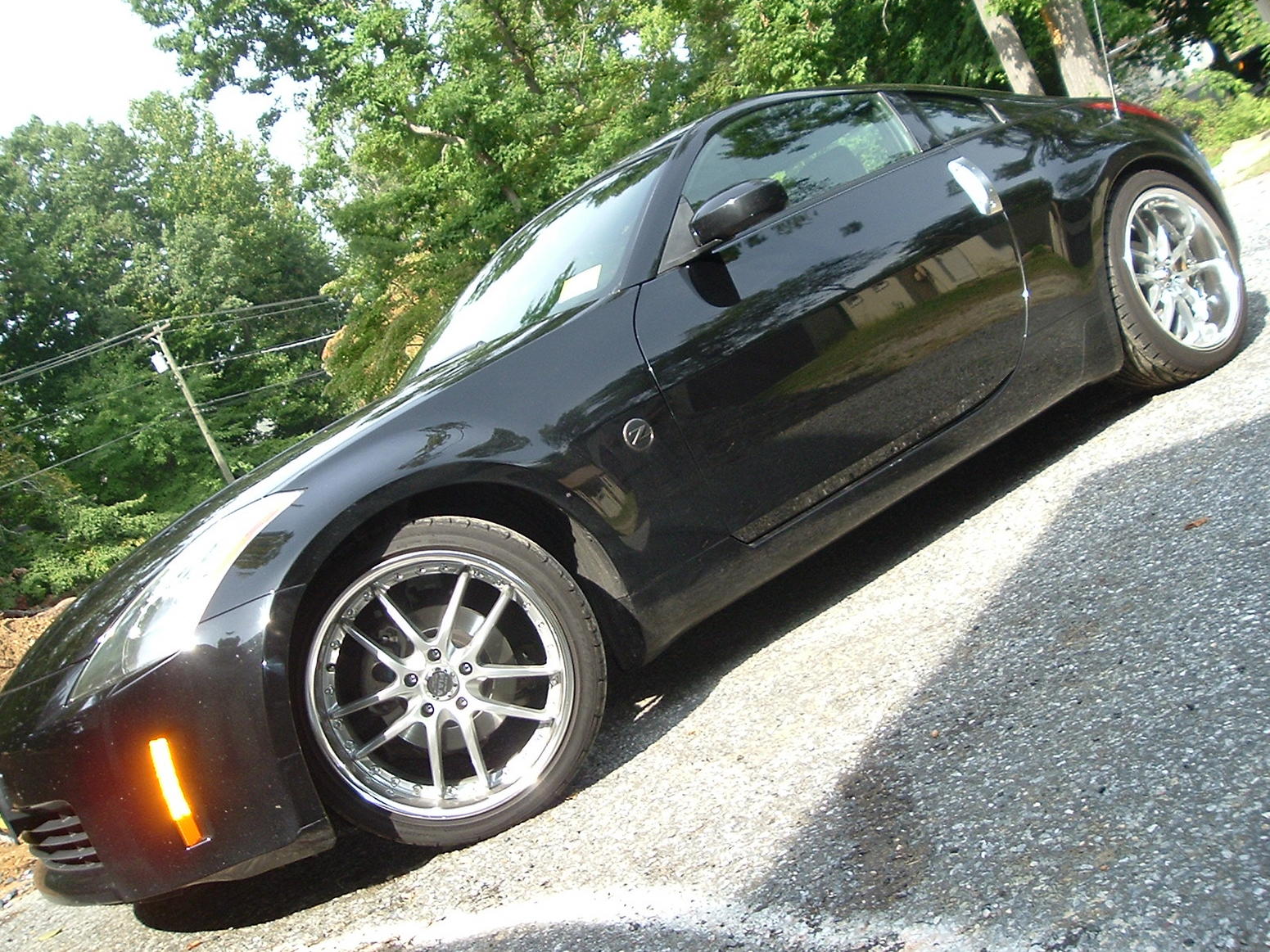

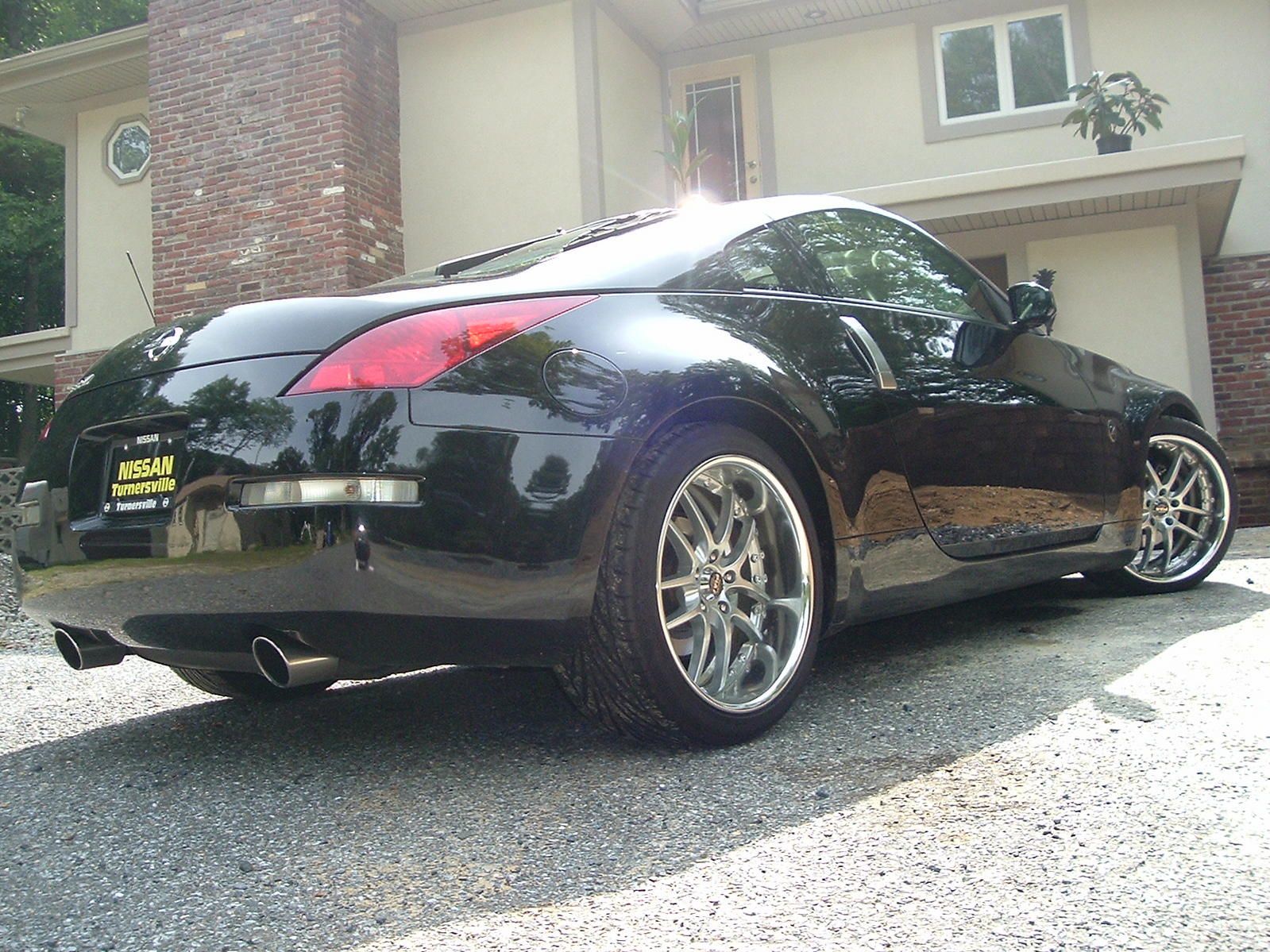

currently
Attached Thumbnails Spacer advice please-tree-fiddy-010.jpg   Spacer advice please-tree-fiddy-008.jpg   Spacer advice please-tree-fiddy-012.jpg
