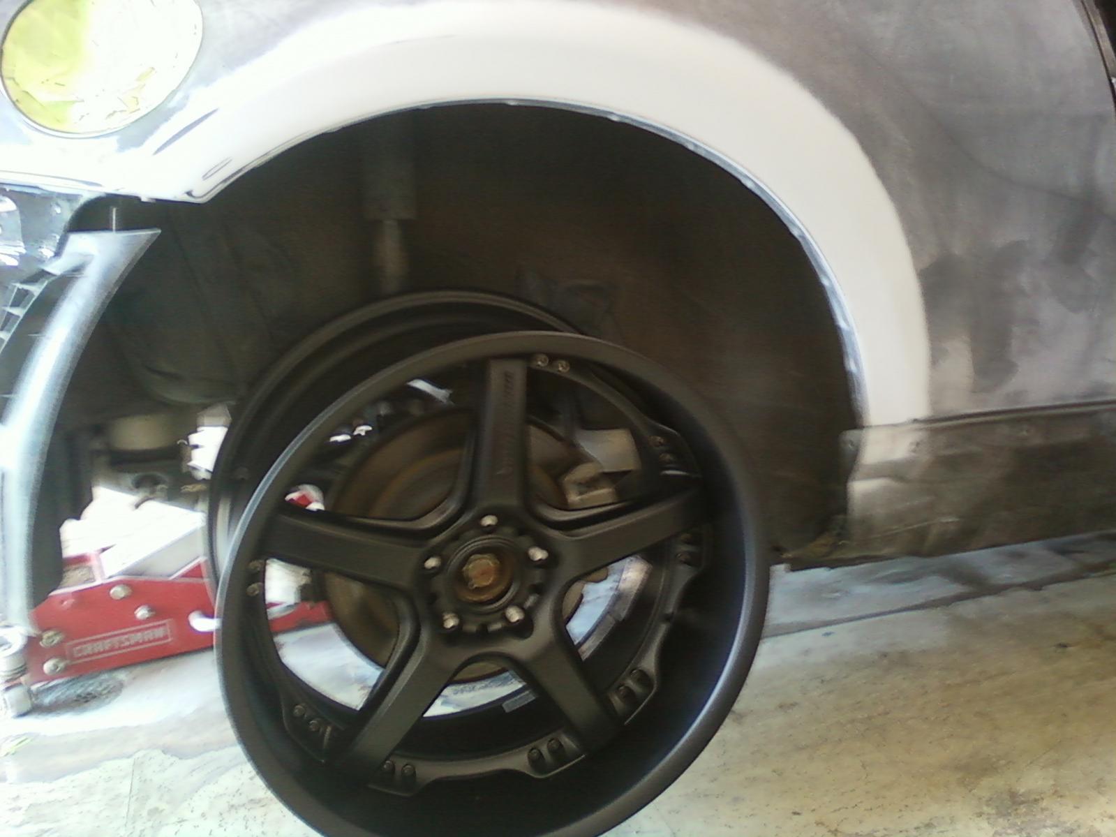

So I just got the tires mounted today but.., wheels are 9.5/+17 and 10.5/+18. I threw one of the rears on the car while it was up in the air and didnt have a tire mounted so I obviously couldnt let the car down. I am running stock suspension at the moment and when I threw the bare rim on the car while in the air it stuck out past the quarter panel by about an inch. When the tires are mounted and the car is sitting on flat ground will the wheel tuck in due to stock camber or not?? I am growing concerned about the rim sticking out far, am I nutz or what?

no, you're not nuts, lol. it should fit pretty flush with the fender depending on your tire size.

those are my favorite wheels. congrats. but you'll need to run some negative camber for those wheels/tires to fit. probably ~2-2.5. I'm at 2.5 with the same offsets. did you get the rear camber kit? you'll definitely need that. you'll also need to cut/roll fenders.

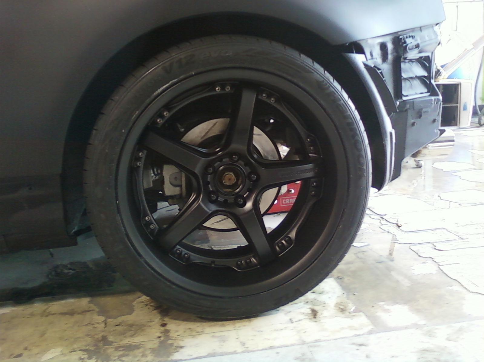

Got them mounted in the rear, 19x10.5/+18....285/35/19. They ended up sitting great on the stock suspension and dont require a camber adjustment.
