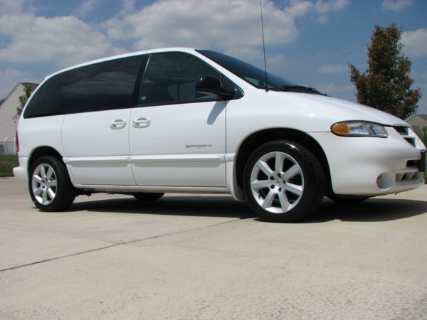

The only way to know for certain if a wheel from another vehicle will fit your Z is to try it. As an example, I put my 17" Z wheels on my Dodge Minivan. Here is a pic....................
You can mix and match most anything if the bolt pattern is correct.
There is more than bolt pattern to worry about. Offset can make a huge difference in clearance as well as handling. Also, any time you change wheels make sure that the lug nuts match the wheel and not just have the right thread for the bolts.
