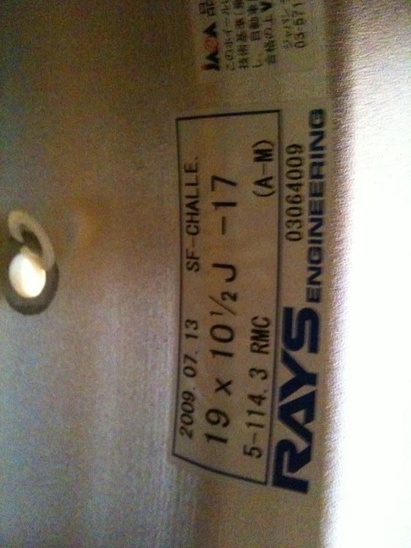

Hey thanks for the reply. The rear wheel is in fact (-17) offset. Fenders have been rolled and wide body kits has been installed. Thanks for the link to the top 100 questions. There was some good info in there but, I didnt't really see a solid answer my particular wheel situation. As I am coming to find out -17 is definately an uncommon offset. So if you know anyone that has something similar that I could ask or talk to that would be very helpful. Thanks again.

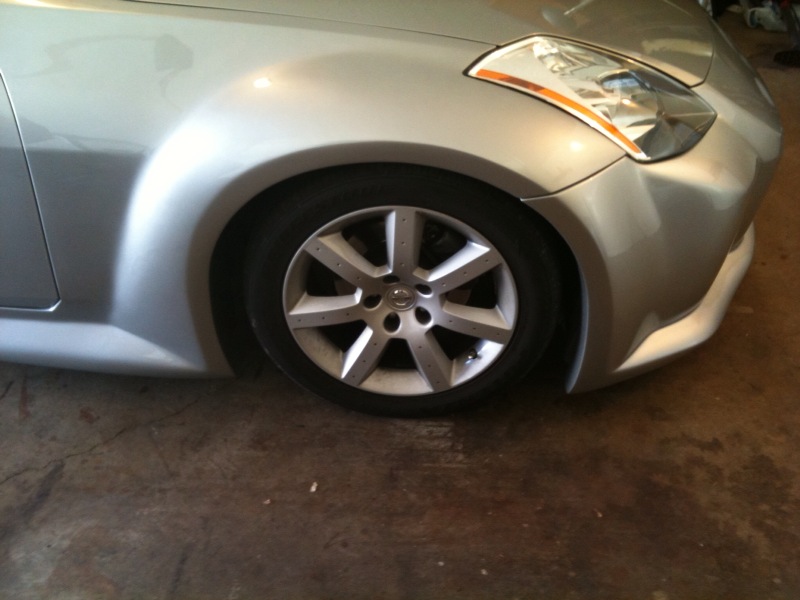

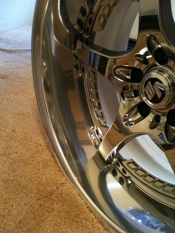

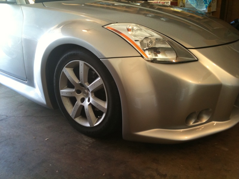

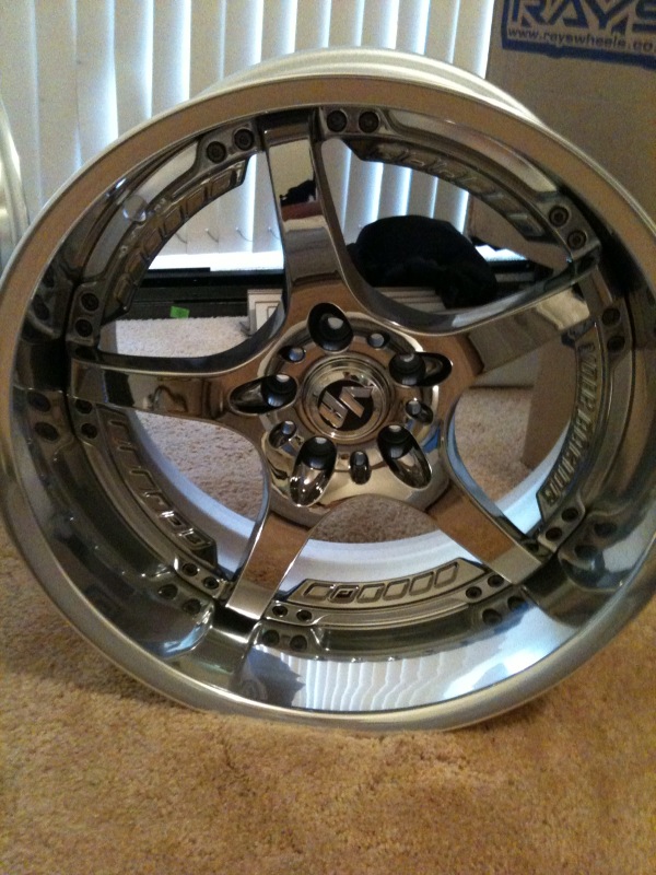

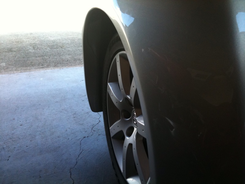

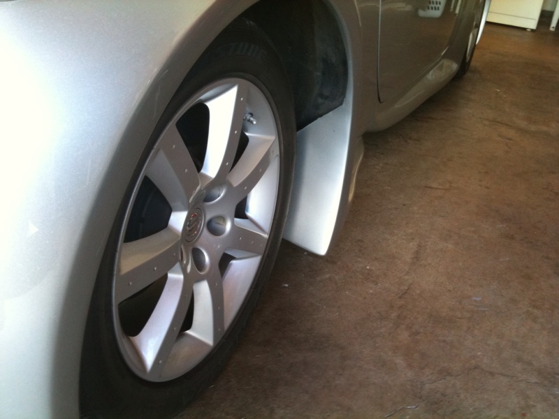

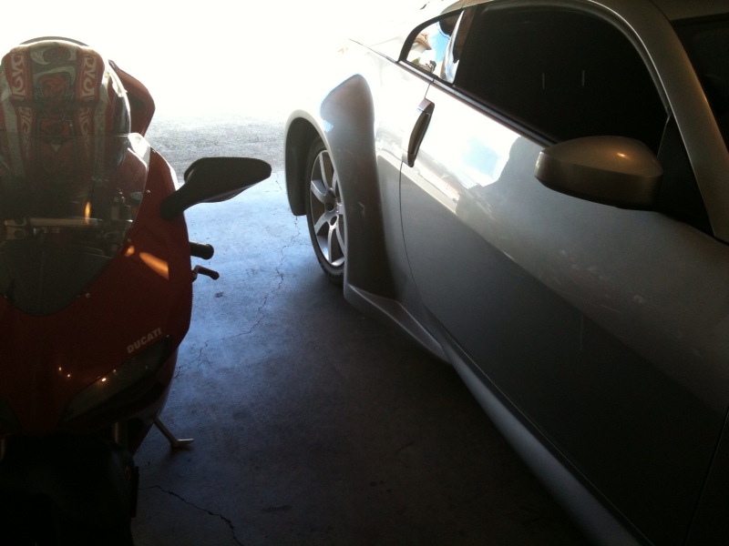

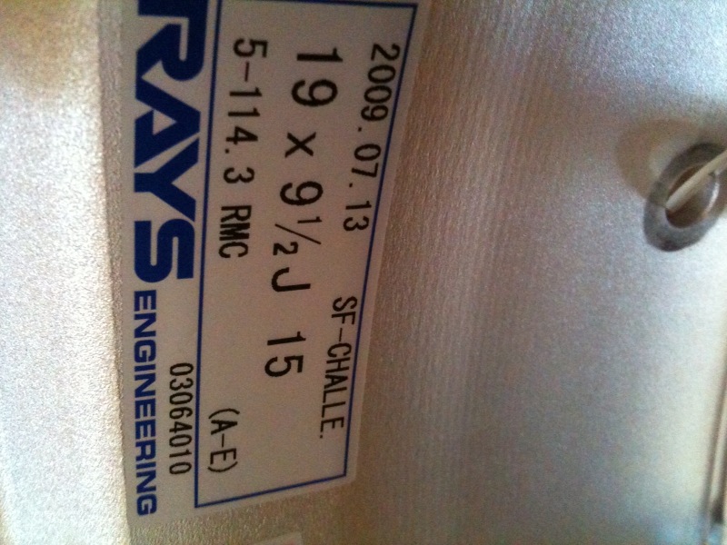

Ok guys here are some pics. They were taken with my phone so may not be the best quality but, should give you a good idea. I think I have already decided what I am going with but, let me know what you think. I'm thinking about 255/35 in the front and 295/30 in the rear. Wrapped with PS2's all around.
Attached Thumbnails Tire size help!-new-rear-1.jpg   Tire size help!-new-rear-2.jpg   Tire size help!-new-rear-3.jpg   Tire size help!-new-front-1.jpg   Tire size help!-new-front-2.jpg

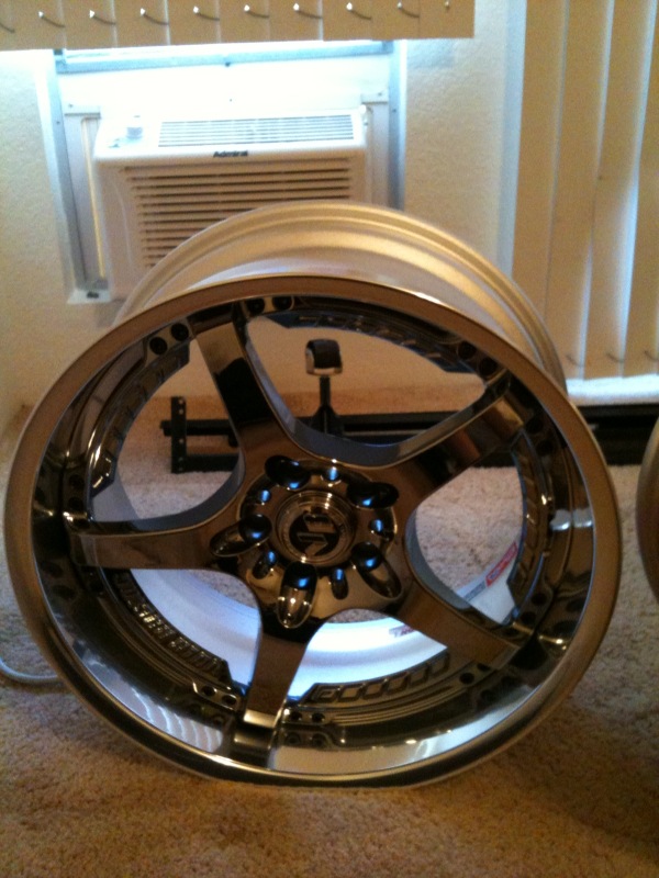

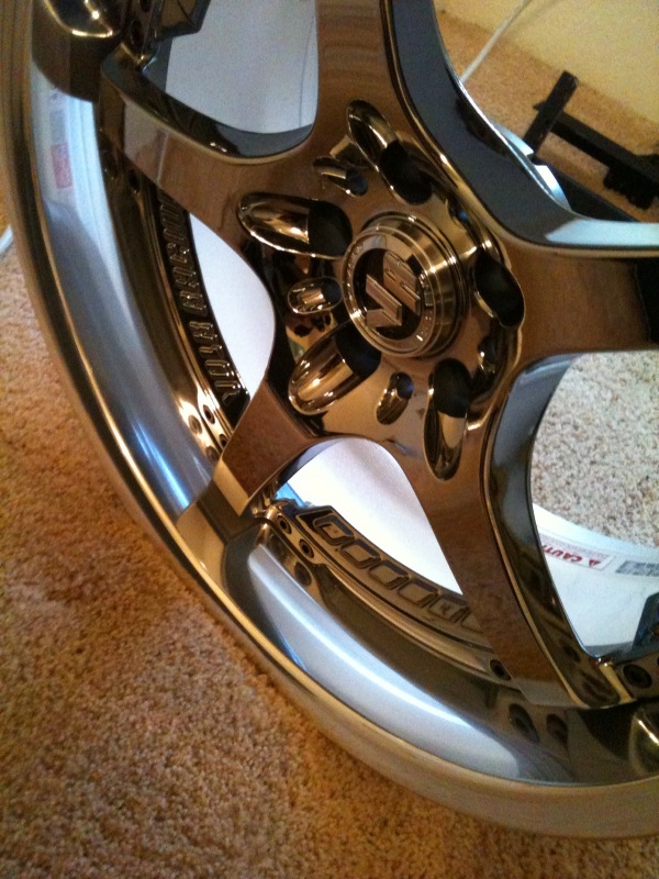

more pics
Attached Thumbnails Tire size help!-new-front-3.jpg   Tire size help!-car-1.jpg   Tire size help!-car-2.jpg   Tire size help!-car-3.jpg   Tire size help!-car-4.jpg

ya -17 offset is definitely gonna look nice with that kit. Good choice on tires

You should have started this thread with the pictures. Doing that would have avoided confusion and your thread would have received better advice from the onset. And... I wonder if you should have wider rear wheels?
Front tires are taller than rear.
