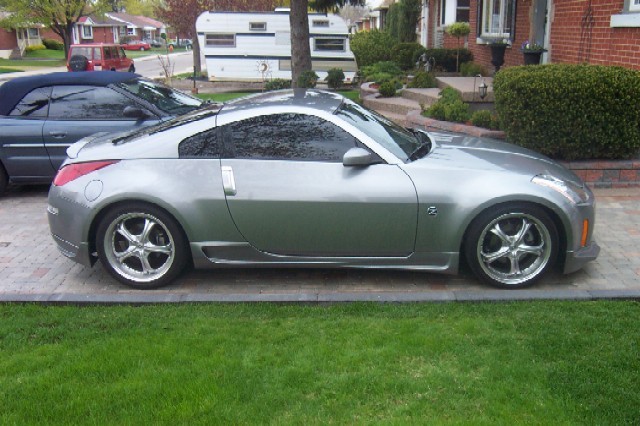

I put on the Pro-Kit with 19" rims 245/35/19 on the front and 275/35/19 on the back , as of right now the measurements are as follows
Front : 26" from the pavement to the top of the wheel well
Back: 26 1/4 " from the pavement to the top of the wheel well
I have them installed around May of this year.
Now those tires I choose gave me the same profile as stock then I put on the Eibachs.
