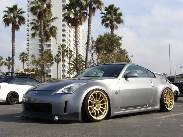

these?
Attached Thumbnails 18x10.5 + 25 SSR Type F with 285s?-350zvenice.jpg   18x10.5 + 25 SSR Type F with 285s?-img_4808-12.jpg

^ those are the wheels...but not the offsets I am looking for....
