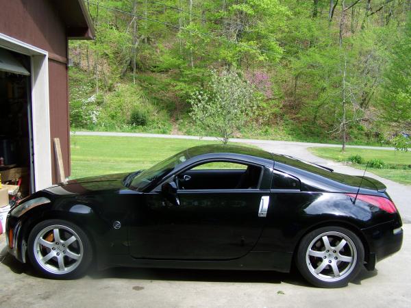

Getting ready to buy a set of 19's for my 2003 Track Model... wheel sizes are 19x9.5 and 19x10.5, +12 offset.
Car is 100% stock, no lowering kit, no rolled fenders.

245/35 275/35 is a popular combo for 19's
if you want more meat go with 255/35 and 295/30

Thanks, Ill probably go with the 275's... im gonna have the rear fenders rolled at some point in time, but I need tires now and I cant find anyone around here that rents fender rollers

275 will likely look a little stretched on a 10.5" wheel. I say likely because some 275s run wider than others, but I suggest a 285 minimum on a 10.5. The 9.5 should have a 265 minimum to not look stretched, but those are aggressive offsets. You don't want them stocking out past the fender, regardless of if you can make it not rub.

+12 , you need to do the 245/35 275/35 combo to keep it from rubbing. You may still need a roll, once you lower, you will need it rolled.
