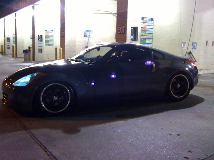

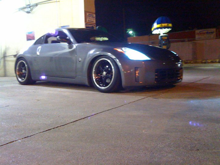

Ok this is my first post so please take it easy on me. I looked around and can't really find a answer. I have a 03 touring that is slammed. I'm running 245/40/18 and 275/40/18 on a 8.5 and 9.5 wheel. I wanted to slam it lower but I'm already maxed out on the front when I turn the wheel I have no gap between the tire and fender. I also want to go lower in the back also. I was wondering what tire sizes can I run without messing with the vdc. I was thinking a 255/35 and 265/35? Please someone help me and I'm sorry if there is a thread about this already and I just didnt see it. Oh I'm lowered on stance gr+ pro true coilovers if that matters.

Sorry for bad quality pics but there the only ones I have. I'm about a inch lower now and the coilovers are settled. That was the day I put my coilovers on. thanks diablox1 for the tire size calculator I didnt even think of looking for that :P

Looking cool may give VDC a headache.
255 is 10 mm wider than 245. So you are going the wrong way here.
265 is 10 mm more narrow than 275. This gives you an extra 5 mm space on each side. This is the direction you want to go.
