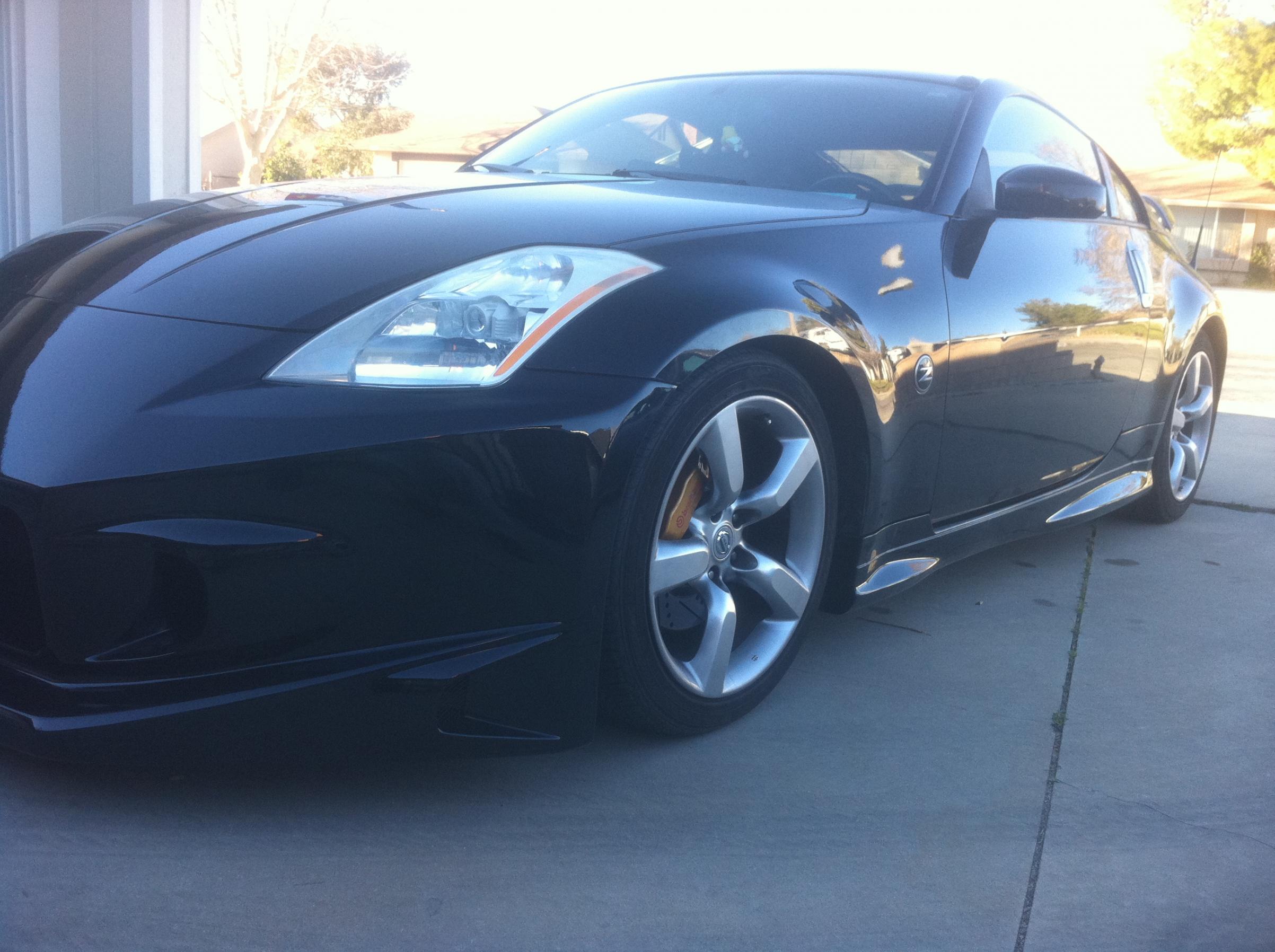

I just added these springs this week Hotchkis. Im about to put on some 20 inch axis wheel but different tire set up.
