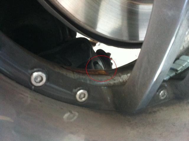

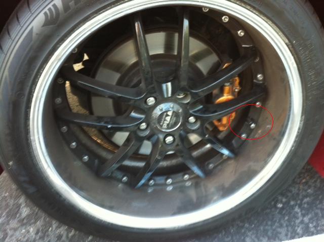

Here are 2 pics of my wheels.
On the far shot, the stem valve is on the bottom right corner and this was the one that they kept on the wheel to put in air. I circled it in red.
On the close up shot, you can see the valve stem is sticking out the back side of the tire. It is circled in red also.
Doesnt look correct to me. =(

I guess I havent had too many wheels.... BUT, OP said that the SHOP made the 2nd hole. I know someone on here has had PIAA rims like this.
Chirag
Agreed. Doesnt look correct. I would say if it works, use it, but you said the TPMS light is on in your car all the time? Tell the shop to get you new TPMS, or wheels.

Cpatel, the early PIAA Super Rozza wheels could not accommodate the TPMS in the standard air valve position and didn’t have any alternative brackets for them. It looks like the tire shop found an innovative solution. As you know Nissans need a special tool to calibrate the TPMS units to the car’s ECU. Shouldn’t be too hard for the Nissan tech to reach around with the reader to calibrate.
