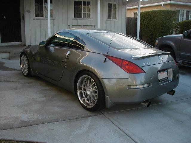

Default here's my car
the car will look hot lowered with 19's. Depending on your offset, if they aren't sticking out too far, you can go as low as 50mm and it will look hot. My car is only 20mm down, but i scrape the plastic aero thing in the front occasionally so i'm not going to go any lower.

whats the specs on those rims? offsets?

19x9 +26 F if you have brembos, you can put +17 F if you plan to keep stock (non brembo) brakes and like deep lip rims. 19x10 +17 R. racinghart C4.

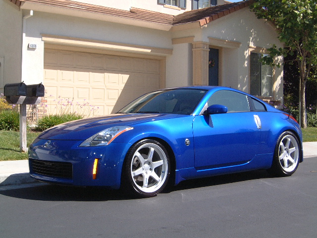

Default Here is mine with Tein Flex....
