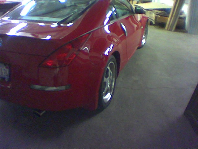

anyone riding on 18 X 7.5 rims?

any problems? appearance? performace?
what size rubber you running?
thanks

I've got a performance model and I'm running 18x7.5's. I got sent the wrong size. But I had waited so long, that I just put them on anyway. The front's are perfect with the 225/45's. Sidewall sits up straight and the rim protection on the tire actually works now. The 245/45 is pushing it. It looks a little meaty in back.
Also, If you keep the stock tires, you will notice that some understeer is gone with the 7.5's.
