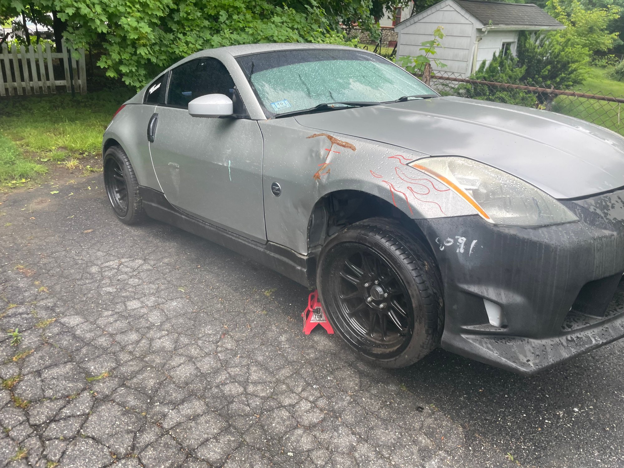

Originally Posted by chris_sanchez
Anyone have these on their 350z and can tell me how they turned out? I've been looking everywhere and can't find a single z with them on. Pictures if you have them.
So these are my cosmis wheels I just got the wheels fit nice I personally love them don’t mind my z I bought from the junk yard I work for best 500 bucks I’ve ever spent 😂
