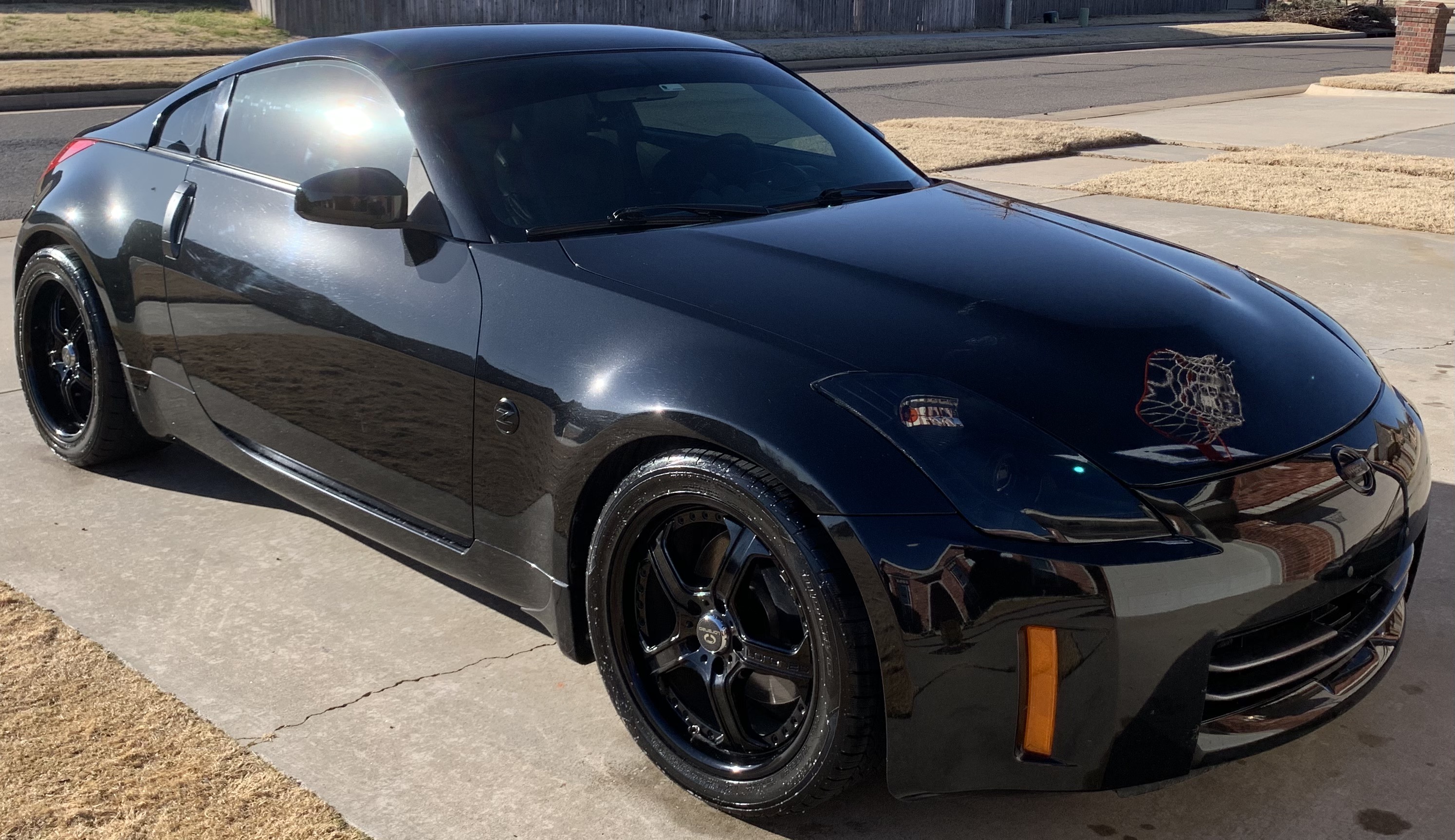

Dude this post makes me so happy. I just bought these exact wheels for my BLACK 2007 350Z. I have always loved the look of these rims and since I wanted an extra wheel set for autocross, it was a win win. Your pictures show what my car will look like, and I LOVE the result. Everything is black on my car, so I thought about blacking the wheels out, but after seeing them here, I have second thoughts.

Hey I know this post is old, but I really appreciate you posting this. I just bought these exact wheels for my BLACK 350Z, so now I get to see them in action before I get them! I needed a set of track rims, but after seeing yours I think these may become my daily drivers and my old ones will become the track rims. I even thought about blacking them out since my Z is all blacked out, but I really dig this look. Thanks!
