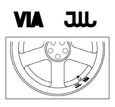

JWL/VIA Construction Standards and "Certification"
Of course, all manufacturers claim to build strong wheels at every price point. Some of these "lower end wheel manufacturers" offer lifetime damage warranties on their products, which I found very interesting and confidence inspiring. Well, sort of.
Many wheel manufacturers even cast the JWL logo right onto the wheel rim or spoke to illustrate that they've built these wheels to the "Japan Light Alloy Wheel standards". Many others add, in addition to the JWL logo, the "VIA" logo next to the JWL casting indicating that they've actually been randomly tested to the JWL standard by Japan's Vehicle Inspection Association (VIA).
This is a key point to consider because anyone can claim JWL build quality but to achieve VIA approval, the wheel must actually be tested to be granted a passing grade by VIA.
OK, yes, I'm positive that there are companies out there that are unscrupulous enough to claim VIA certification without actually having been tested, because honestly, who's going to check this claim on wheels sold outside of Japan where the JWL/VIA is the only place it's really applicable and enforceable? I mean, after all, they already copied someone else's design, right? What's one more "infraction" where the almighty US dollar is at stake?

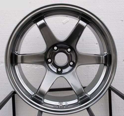

- Volk TE37 reps - always a winner, style wise.

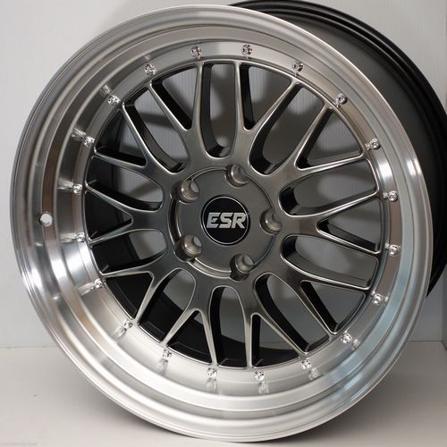

- BBS LM or Work VSXX reps (basically same basket weave style) - likewise, one of my all time favorite styles.

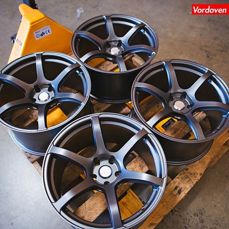

After days of searching frustration (and yes, boredom), I was just about to pull the trigger on a set of BBS-LM reps just to get on with things. But then, I took one last look around the web (yeah, EBay... ) and happened upon a set of Vordoven Forme 6 wheels that really hit my sweet spot for some reason. I remembered that someone posted here about them a while back so they were not totally unknown to me.
After going back and forth with both Vordoven and one of their resellers to verify fit, conformance with JWL/VIA and so forth, I dropped my coin on a set of them in 18x9.5 +34 Front and 19x10.5 +22 Rear.
They appear to be an "almost replica" of a Yokohama/Advan RG-II wheel. (First page of this thread shows a picture of a genuine RG-II)
Cost for the set, including shipping and subsequent mounting and balancing: $800.

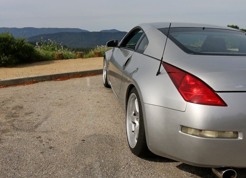

Do I like them on the car? Welllllll, they're "OK" in my eyes. But just based on appearance, they're the least favorite of the four sets I now own, the Volk SFWs, the S-Tunes, these Vordovens, and a set of these Z34Ns:
Yes, both of my no-longer-owned cars. Sniff sniff. (But maybe one day, my daughter will give the white one back to me.... hahahaha.)
I should note that fitment is good but I think the dark color of the wheels make them get a little "lost" on my car. But no matter, purpose here is to test how well they work - or don't work as we'll find out.
To recap: A Quick Note on Fitment
18x9.5 +19 effective wheel offset (+34mm actual offset less 15mm spacer = +19mm effective) with 245/40-18 Yokohama AD08 Front
19x10.5 +22 with 265/35-19 Yokohama AD08 Rear
Car is static lowered 22mm.
There is NO fender nor suspension/brake interference at full lock or over any bumps with this set up.
