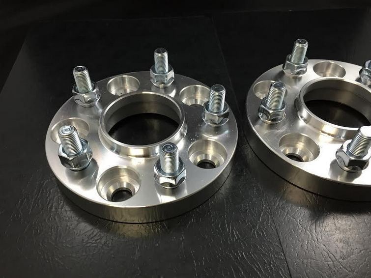

20mm spacers work. I have Z34 wheels on my Z33 (and another set of Z34Ns in my garage) and have NO problems.

No, the wheel spacers have their own studs and they install over and through the old studs. The old studs protrude out past the adapter face a bit so make sure wheels you get have the mounting face recesses to allow for this. All Nissan OEM wheels do (as do most aftermarket wheels).
