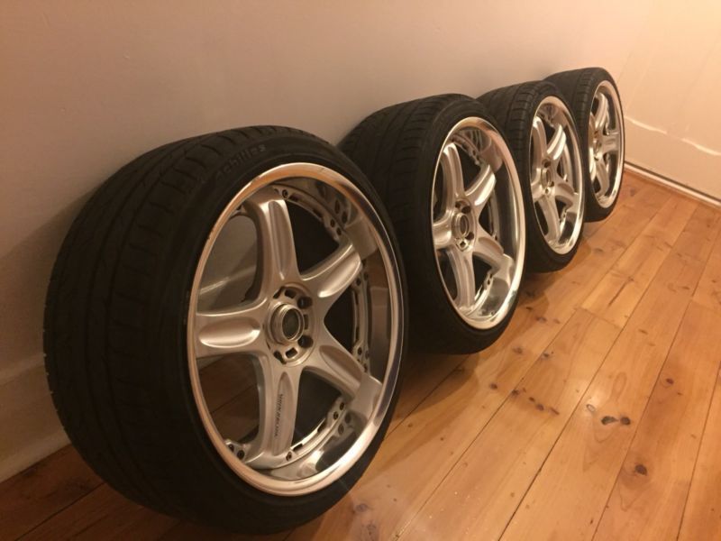

Hey guys,
Just got my 350z a few months ago and want to get some new wheels for it.
Fronts are 19x8.5
19 offset
Rears are 19x9.5
24 offset
My car is stock height, would like to know if these wheels will clear the brembos and not rub etc.
Thanks for any help, looking forward to being more involved in the 350 community!

Might be a tight fit. These are 19x8.5 +27 and they fit fine but the +19s might have a different face contour (slightly less concave.)
Can you try then before buying?
Rears are fine. I put that exact offset on the rear of my Niz to try them for the guy who bought them from me.

Thanks for the quick response!
Unfortunately seller advised me they don't have time for me to try first.
If it's a tight fit, would a small 3-5mm spacer get me out of trouble?

Yep, that's what I was also going to suggest. The faces are concave enough that you should be able to space it out a bit for caliper clearance and the big barrels will clear for sure. 8.5 wide with 245s most likely will not cause fender interference.

I used to have a set and cleared akebono BBK's with about an inch drop on 275r, 245f, you will be fine.

In those same sizes and offset? If so that's great to know they'll fit.
