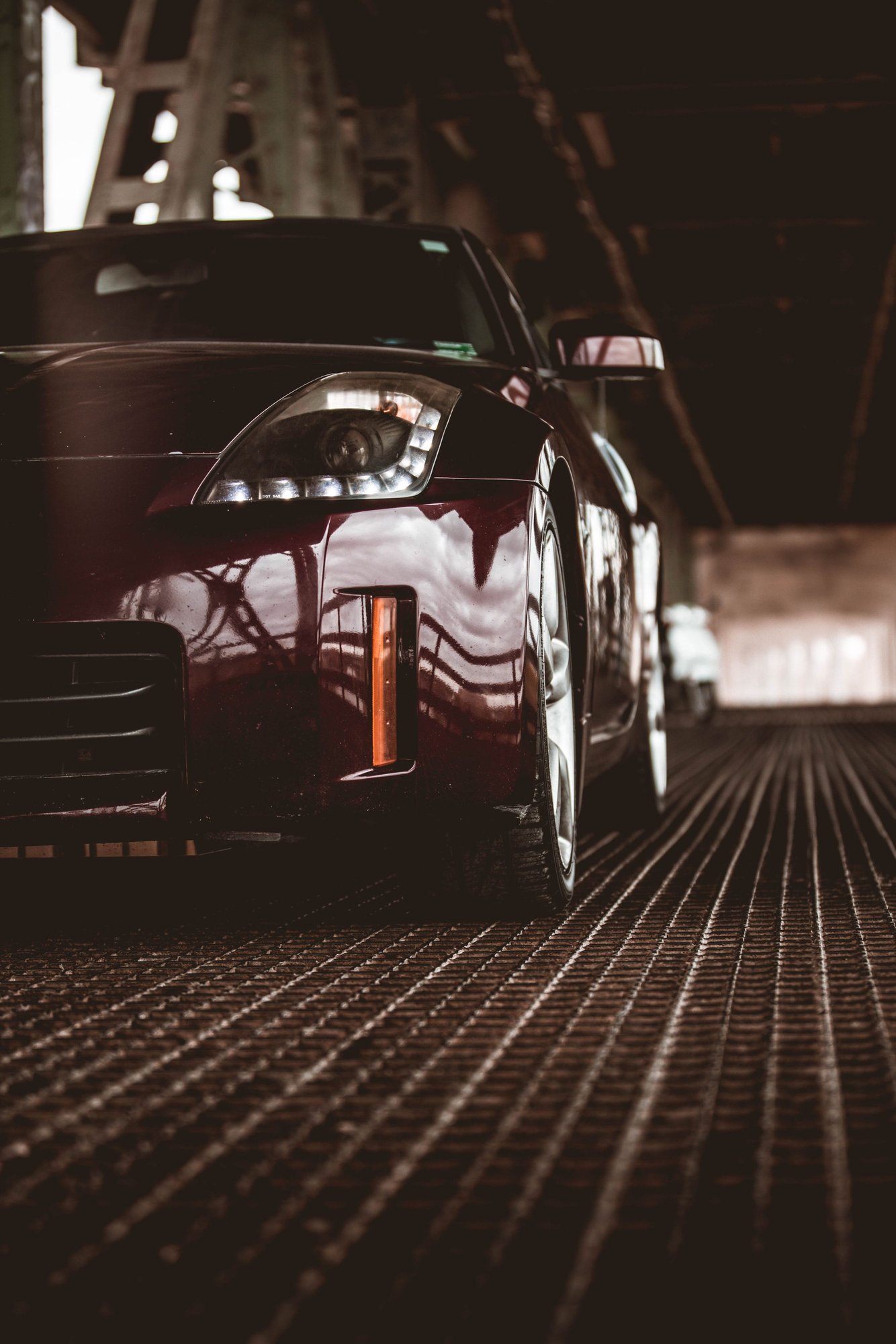

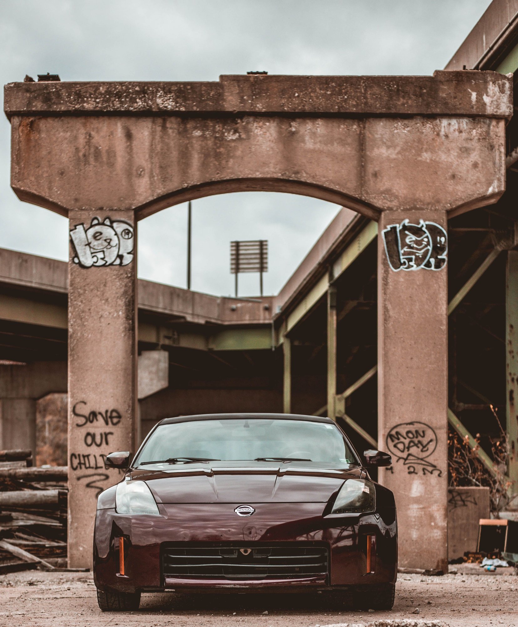

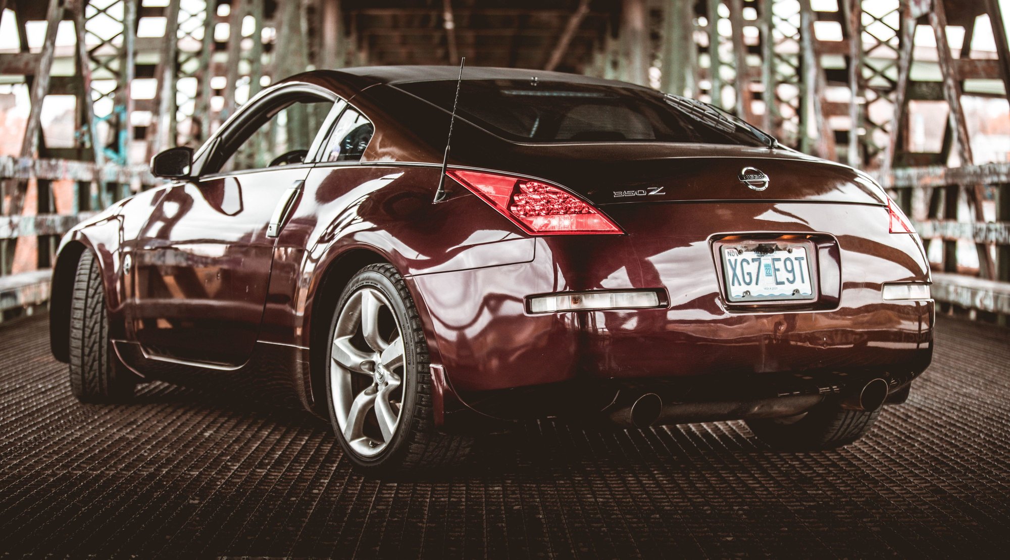

good afternoon i just bought a new set of aftermarket coil-overs ( to be specific i got the tein Z flex coil over kit ) i was wondering what wheels sizes would make a good flush fitment
also some good tire recommendations would help to
here are some photos of my Z

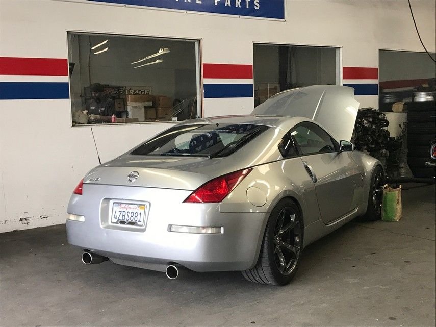

Originally Posted by Angel Velez
the 22 offset i think is close to flush i see alot of poeple running +22 squared with the 275 in the rear i wonder if the rear is going to poke due to the photos i saw on -line plz send pics of the exact setup you sent me
No poke. Takes really low offset and/or really wide tires to cause poke.
Following are a few of the wheels either naturally around 22mm or spaced down to 22 or lower. All are 19" unless noted (the only thing to study here is the width and offset.) Car is lowered conservatively (19mm), factory camber settings.
Volk SF Winning
19x9.5 +19 245/35-19
19x10.5 +9 275/35-19
Enkei/AME TM-02
19x9.5 +22 with 255/35-19
19x10.5 +22 with 285/35-19
Rear
Nismo LMZ-5
19x9 +20 (spaced) 245/35-19
19x10 +23 275/35-19
RPF1
18x9.5 +15 245/40, 275/40-18
Nismo LMGT5
19x9.5 +20 (spaced) 255/35-19
19x10.5 +23 285/35-19
Volk SF Winning
19x10.5 +19 (Spaced) 275/35-19

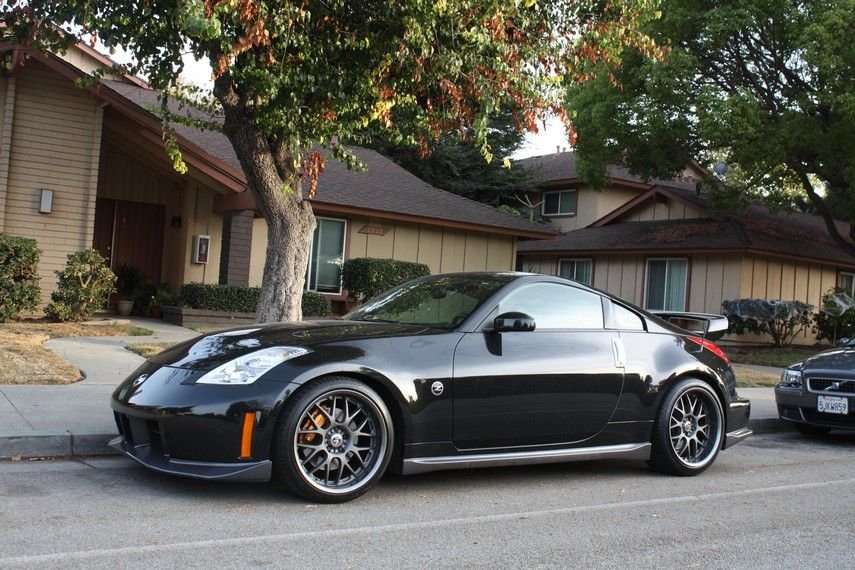

18"
My setup
https://my350z.com/forum/wheels-and-...ml#post9513000
