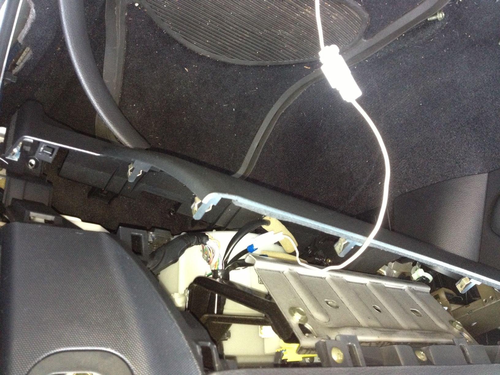

Can anyone tell me where to find the TPMS connector on an 06? Just replaced wheels, rubbers, and TPM sensors and they aint online. I looked all around the datalink connector and have not found it. I understand you have to ground it under power 6 times and drive it to relearn but I can't find it. Anyone know? Thank you in advance for any help.................-Curtis

Yes but I need to know where the connector is so that I can put the ECM into learning mode.............-Curtis

It's under the dash. A white connector with 1 wire leading to it.
On the '06, I think it's on the right side

Found it last night, did the relearn procedure and it's all good. Thanks again!............-Curtis
