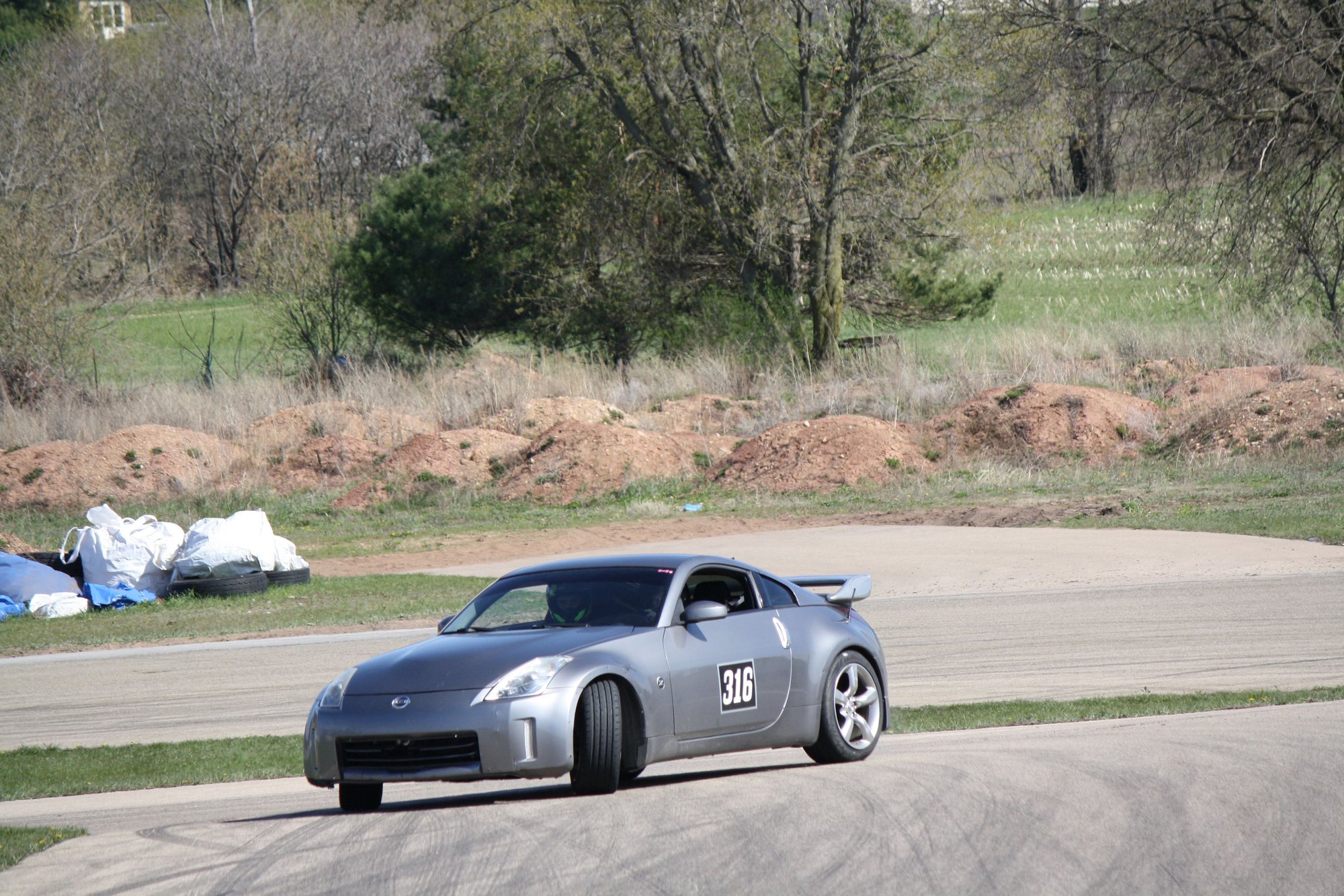

As such, for performance, that size will fit nearly perfect with a set of either square tires or staggered in upsized tires 245/40-18F & 275/40-18R. No adjustments to suspension nor fender modifications are likely necessary FOR THE WHEELS. But, you may need to correct the camber and toe depending on the amount of drop you set the Tein c/os at. General rule of thumb: if you drop 20-25mm, you will likely be OK without NEEDING to adjust alignment settings. More than that, recommended you install rear camber arms & offset bushings and adjustable FUCA (front upper control arm) to bring alignment back into spec. But the key is to be able to set alignment to your needs. Looks like you track the car (from the pic). It's nice to be able to set alignment for the track and return it to stock range for street/highway if desired.
