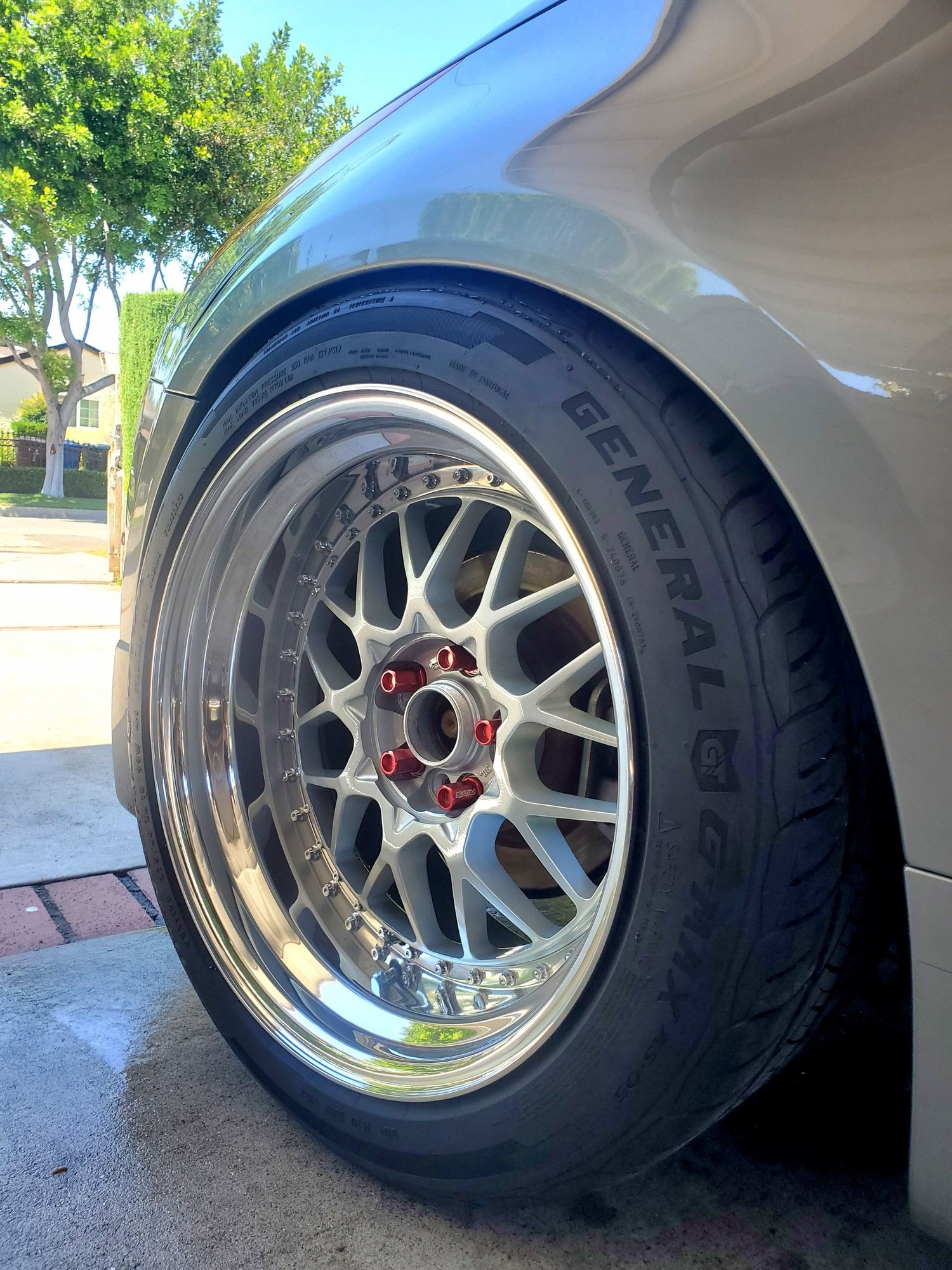

So I got the wheels on and there is some rubbing in the rear even though the wheels are the same specs as my old ones. Only difference as I mentioned is the offset being +8 now before on rear the specs were 18x10.5 +20 with a 15mm spacer.
I thought the fronts would give me some rubbing issues but none. Im not sure why I would get rubbing in the rear now as i didnt before. Anyway as much as i wanted to keep the car lowered as it was i raised it from the rear a bit and kinda mess with the camber to get enough clearance for now until i take it to get it aligned on the weekend. Heres a pic of how the rears initially sat at first before raising the rear.

Your previous wheels with spacers were more aggressive by 3mm as compared to your new wheels. Yet the previous wheels did not rub. Most likely threw off the alignment enough to cause rubbage when you messed with it.

Questions:
- Refresh my fading memory-did you roll the fenders?
- Your comment: "Work VS-X9 18x9.5 and 18X10.5 offsets +8 re lipped and re barreled."
So, how are you sure the offset is +8? I would posit that the re-barrel or lip altered your offset by a bit, enough to cause interference is answer to the above is "no".
- Did you move your existing tires over or new/different brand? Some tires are wider than others despite being labeled the same width, e.g., "275".

Im using the same tires. That were on my other wheels. I also thought that the offsets may not have been +8.
I bought these wheels from VR wheels. They import wheels from Japan and also produce their own line of wheels. New inner barrels and lips were used on the set I bought. I did email them about this and was told to bring in one of the wheels to measure the offset to confirm this. How hard is it to measure the offset? Maybe I can do this. I've seen videos but don't quite understand it

I got the car aligned and everything clears good. Only rubbing I have is when im backing out of the driveway but nothing crazy. I still have a feeling the wheels were built with a lower offset than +5 and not +8. I will measure at some point just to know exactly what I have.
